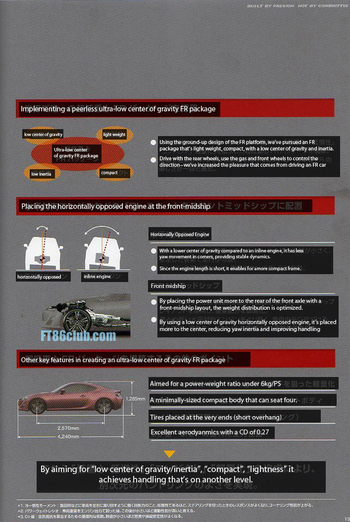

Originally Posted by Hachiroku View Post
Key Info:
  • 460mm from ground to the center of the crank/gravity (low CG)
  • 53:47 F/R weight split
  • 0.27 Cd (coefficient of drag)
  • D-4S DI engine tech (direct injection pairs with secondary EFI)
  • 1,998cc Displacement
  • 200 HP
  • 151.2 ft-lbs torque
  • 7400rpm redline
  • 12.5:1 Compression ratio
  • 86mm x 86mm bore/stroke
  • Mcpherson front suspension / Double wishbone rear
  • Rear seats fold (as one unit)
  • Cup holders can slide / be removed
  • Can carry 4 tires in rear
Translated scans (big thanks to AKI !!!):
Attachment 2505
Attachment 2506
Attachment 2508
Attachment 2509
Attachment 2510
Attachment 2512
Attachment 2513

If this has been talked about elsewhere, can't find it. Toyota claims the GT86's 460 mm C of G height is surpassed only by exotic cars like the Ferrari 360 and the Lexus LFA. I dug up a 2010 SAE paper that lists "driver only" centers of gravity measurements of older cars. As expected, almost all cars listed have higher C of Gs (e.g., the 2003 Honda S2000 is 471 mm). However, the 2003 Mazda Miata is only 450 mm. Does this car not count because it's not a coupe? Or did Toyota conveniently choose to ignore the Mazda?

Probably because the Miata and S2000 don't have fixed hardtop roofs which I'm assuming takes away a lot of the weight up top?

That was my thinking too. Even without a roof the S2000 has a higher CG than the F86, which shows the advantage of the boxer engine.
