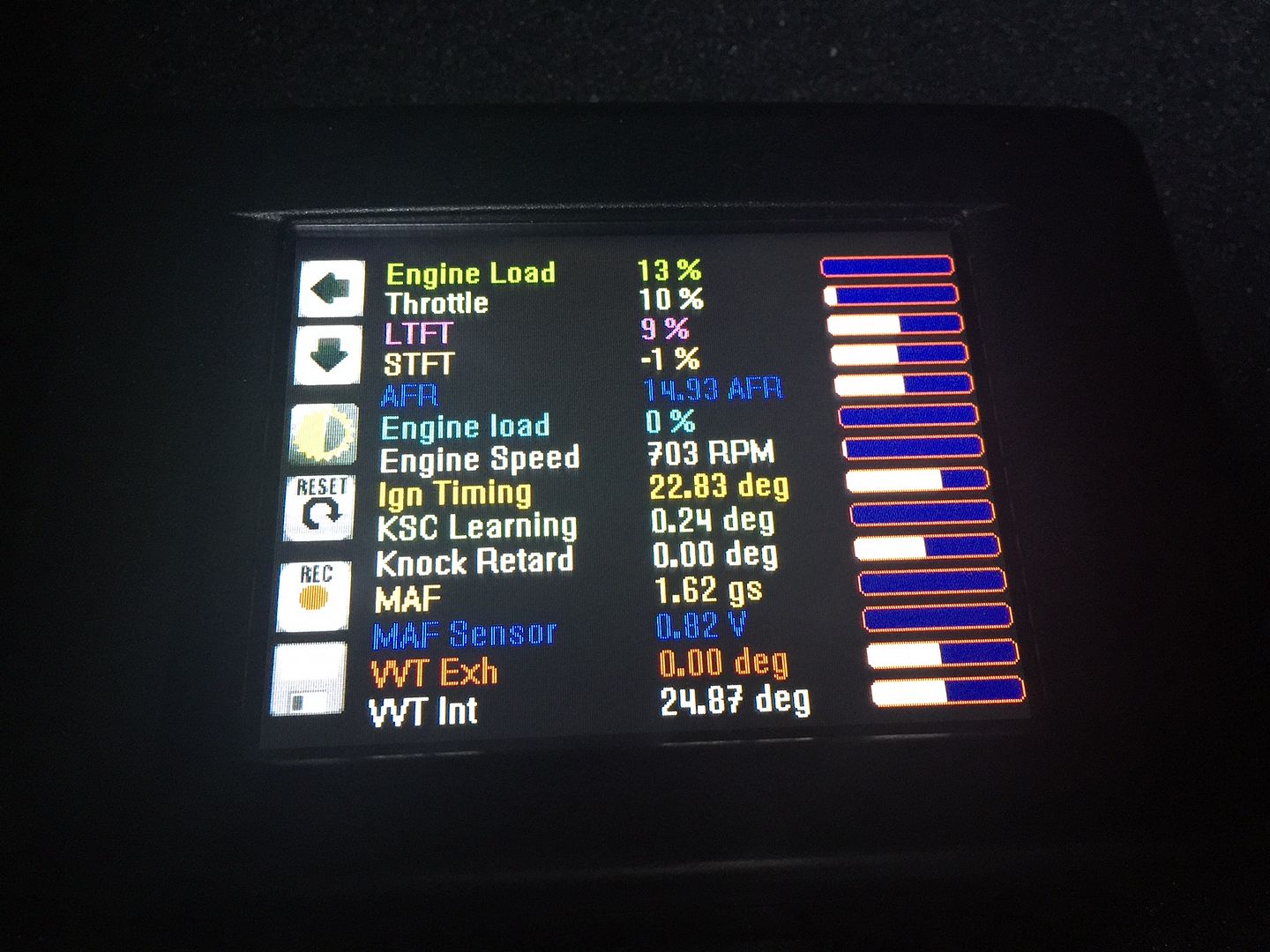

I got my oft 4 days ago and im already facing trouble!
My oft keeps on jamming while its connected (on the engine info) and im driving.
Note: i gota phone holder on the ac vent to hold the oft.
I also emailed them and got no response for almost 2 days

Just trying to get it straight, is it jamming on this screen?
Also Shiv can sometimes take a few days to email back as he is very busy. As for the jamming does it happen right when you enter the screen or have you been driving for a while and it happens?
Yes it happens on that screen, it happens after driving for a while like (4-10 minutez)
