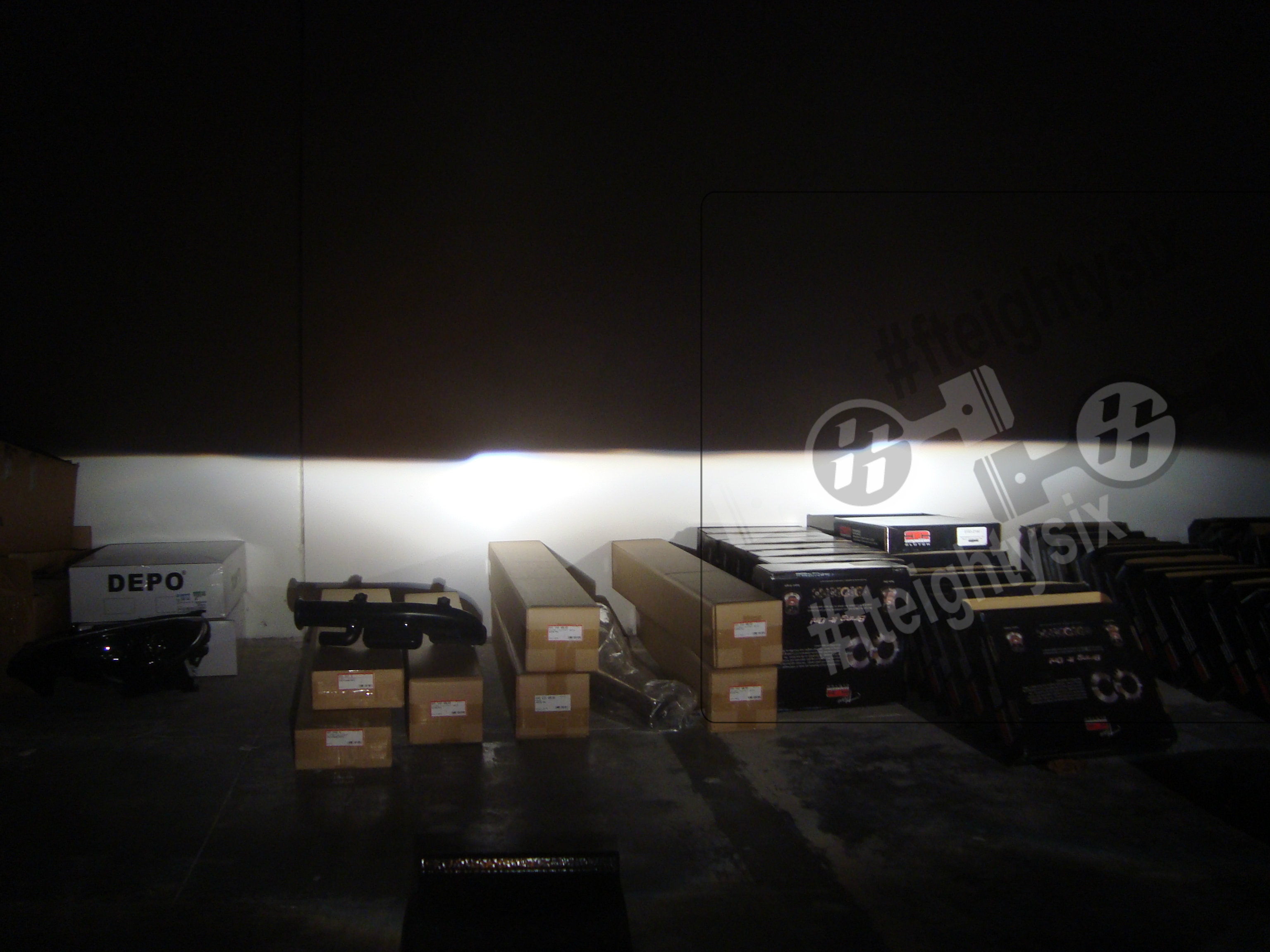

Wow. That is an absolute trash output. There is a crazy amount of glare, and there's no chance you aren't blinding everyone while you're driving.
This is what a proper output is supposed to be:

OP I think the lights look great and this was a very cool project where you got to learn/troubleshoot LED headlights, but the fact is these headlights will blind people as LEDs simply can't cast light through a Xenon projector like an actual xenon bulb.
Leds require special projectors to cast light as effectively as possible. For example, those new fog lights you have seem to have led projectors. You can see it's shaped in a rectangular fashion like an NHL hockey visor. These are what you want retrofitted if you ever wanted to run LED headlights and not blind people.
Also as mentioned before, it's easy to think that these are brighter than stock HID bulbs but if you compare both side by side, you'll see the HID bulb is throwing light further down the road than the LED bulb and still not blinding people.
