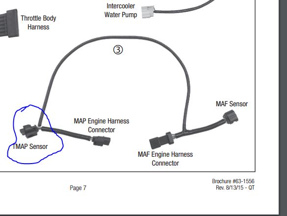

I got to the very very end of the install and I came upon this connector. Where does it go? It's off the tmap harness. The harness is short so the connector is near. By the look of the instructions it should be directly behind the intake manifold sensor, but I don't see it all.
Is this the connector that branches off the TMAP Sensor (labeled "MAP Engine Harness connector" in the manual on page 7)? If it is, that should be plugging into the MAP harness (see step 161).

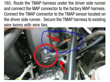

Here's a picture of where I'm having trouble.
I got the harness hooked up to the according to step 161/164. Its the other end where I'm having trouble.
Is the TMAP sensor tucked underneath the SC?
This is the TMAP sensor (red circle). Should be attached to one of the runners.
Sorry I was referring to the other MAP connector.
So it's the MAP connector I'm having trouble connecting/finding.
Sent from my SAMSUNG-SM-G935A using Tapatalk
Then that needs to go to the connector that was originally plugged into the stock MAP sensor on the stock intake.
Yeah noob move on my part lmao. I tucked that connector towards the front when we lowered the SC in. I went back last night with a flash light and bam, unused connecter tucked away.
