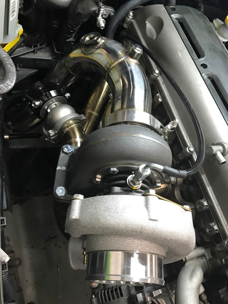

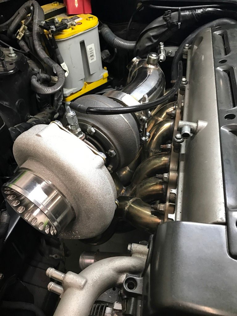

The hot side is done and in the car for the last time! Everything fits pretty well.
We got our oil feed kit installed and the oil drain set up.
The down pipe and dump tube both fit and clear everything including the factory sway bar.
The engine mounts and trans mount are tightened down for the last time.

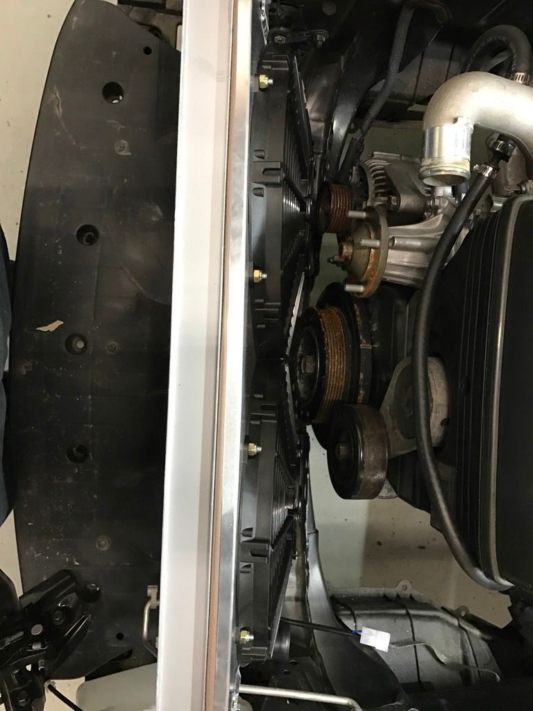

The radiator, fans, and shroud clear everything in the factory mounting position!

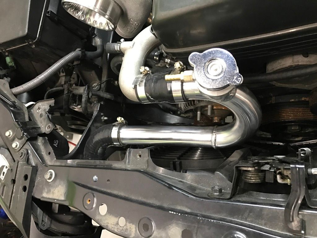

Talk about a simple cooling system, this setup converts the radiator hoses to use the factory radiator. Super easy install, I wish this was around when I did my car 2 years ago!

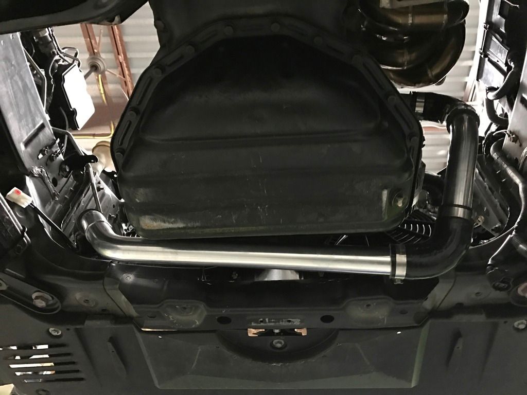

And just like that, the passenger side is done! I'm waiting on 2 more items before I can finish the drivers side, its mostly an order of installation thing, I don't want to have to remove anything again so I'm waiting on the missing pieces. Stay tuned and PS, we are putting all the swap parts together in one place on our site to make collecting things easy!

I'm curious why you didn't cut that metal coolant line and weld an barb to it to clean up that coolant path and leave more room at the front of the engine? Or, after a second look, why not go from the water pump outlet to the passenger side of the radiator? (that's not intended to be criticism, just questions.)

Originally Posted by Calum View Post
It looks fantastic, guys. Thanks for sharing.
One word sums up both of those questions, Repeatability. It took me all of 20 minutes to install this hose setup, its super simple. Furthermore, the position of the cap and how it doubles as a filler neck is very important to minimize air pockets in the cooling system.

we did the same coolant setup on mine. once you get to the point where you can adjust everything for the final time and tighten it all up, it fits pretty well. its nice to have a couple parts already on the market to try. now that we have tested and verified that they will work, we can spend more time finishing the engine management package and intake manifold, and less time trying to design more parts.
