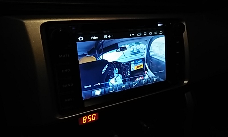

So far so good...still working on the backup camera and I decided to add a powered sub. Gonna try and run the wires today before any rain comes ><
I caught some luck and was able to pick one up used with the harnesses included and re-pinning already done. As usual I'm doing the bulk of my research after the fact...there's several hours worth of reading over at the XDA forums regarding MTCB vs. MTCD units, various ROMS, xposed modules, and on and on. After a lot of reading, some trial and error and a couple of flashes I'm pretty happy with it.
The only drawback is that it is definitely not fast. Once it fully boots up (~30-45 seconds or so in my case) it's pretty good, but if your just shooting down to the corner store I wouldn't even bother turning it on. You can adjust the time until it fully shuts down (I'm using 5 minutes), so if your pumping gas or whatever it will come back up right away. I'd only install what you use regularly on it...I had a bunch of crap like Netflix and DirecTV which is amusing but doesn't help performance wise, lol. Being able to use google maps for navigation is pretty sweet, either download offline areas or tether it to your phone.
What I wound up with is an 800x480 RK3188 MTCB unit and I settled on Malaysk's Sept. 12th 5.1.1 ROM...looks like he has an update coming soon though. I found this to be a good starting point with a bunch of useful links, though some appears to be dated:
http://forum.xda-developers.com/wiki/Hui_Fei_Type
In the end, it's a bit slow and has some quirks but that is completely outweighed by everything you can do with it...well worth it, IMO. Supposedly models with 2GB of RAM and 8 core processors aren't far off and that should do a lot to address the slow boot/speed issues.
*edit: forgot to mention, the radio reception is pretty dismal...not really a big deal to me, but I'm going to double check the antenna connection when I get the camera/sub wires back there...
Pretty bad lighting for pics, but:

I think it looks awesome. Is this the same model as you?
RK PX3 1.6GHz Cortex A9 Quad Core, Resolution 800*480, Support 1080P
joying: SKU: JY-TL123
I really want it for GPS / and hands free everything else is just extra. anything else i need to buy for a smooth install?
steve87j is offline   Reply With Quote
