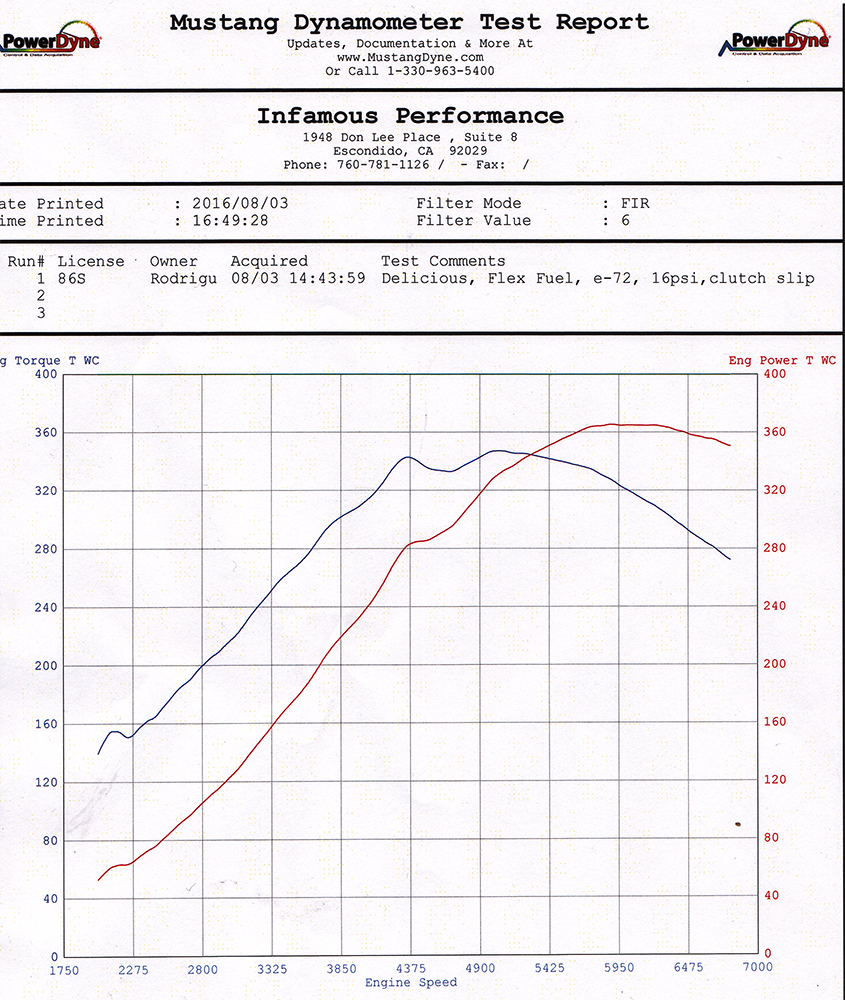

Just decided to share this with you guys, I finally got my 2nd delicious tune done yesterday. Since then we have fully built motor, and decided to up the boost and see what this Garrett GTX2867R can do. Sadly we couldnt reach the 400's since the OS Giken TR2C Twin Plate Clutch started to slip from 6000-7800 RPM on the dyno, I had really high hopes that this OS Giken TPC was going to never have slipping problems. Since it's rated to hold in the upwards of 750WHP, and sadly only reached half of that figure. Once I get the clutch situation sorted, I will probably upgrade to a Garrett GTX3076R or GTX35R.
I attached the dyno of what the car did even though it was slipping really bad in the high RPM's.
Kit: JDL UEL single scroll Garrett GTX2867R @16psi e72
Tune: Delicious Tuning
Engine/Exhaust:Outfront Motorsports Fully Built Closed Deck, JDL Full 3" exhaust, Tomei Type 80
Fuel mods: DW700CC, DW65C, DT Flex Fuel Kit
Dyno whp/wtq: 366WHP/347TQ
