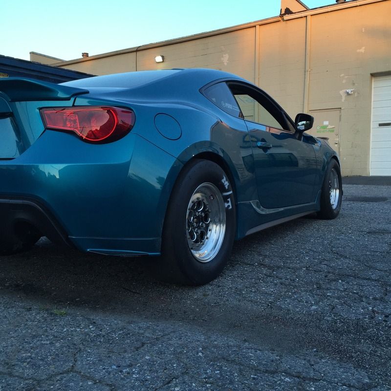

1000hp pro axle setup is installed, as well as a new launch control/traction control setup in motec. Also testing out the welds with 26x10 slicks

Lay down any good times with it?

Sub'd this thing looks awesome, badass updates too. Anybody else want to see this thing on a 1320 video? 🙋

the broken axle kept that from happening. going back tonight though with the new ones
