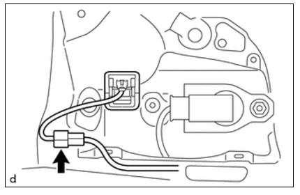

Hook it to the reverse light positive.

Toyota head units (and some of Subaru's) won't work that way -- the HU will fail to see the camera during the HU's boot-up check.

If I had the 2016 wiring diagram for my car i can find out where the cam gets power from... in the FSM it just shows a connector. Probably 2-3 wires.
