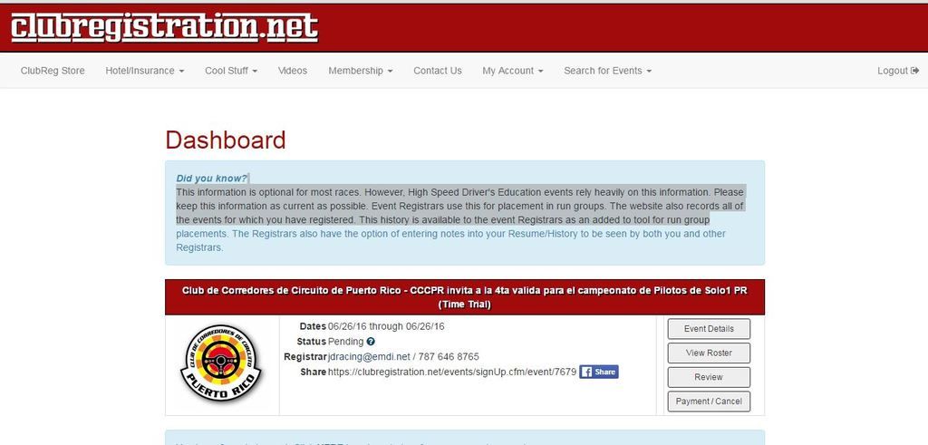

So this will count?
Track day on June 26th where I'll be testing the BBK since I received my lines today and will me mounting them this weekend.

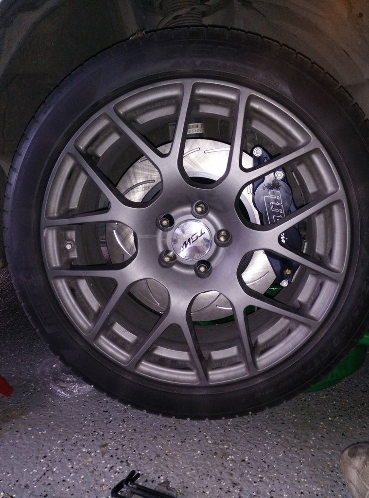

TSW Nurburgring 17x8 +35 have clearance for days with the stage 2.

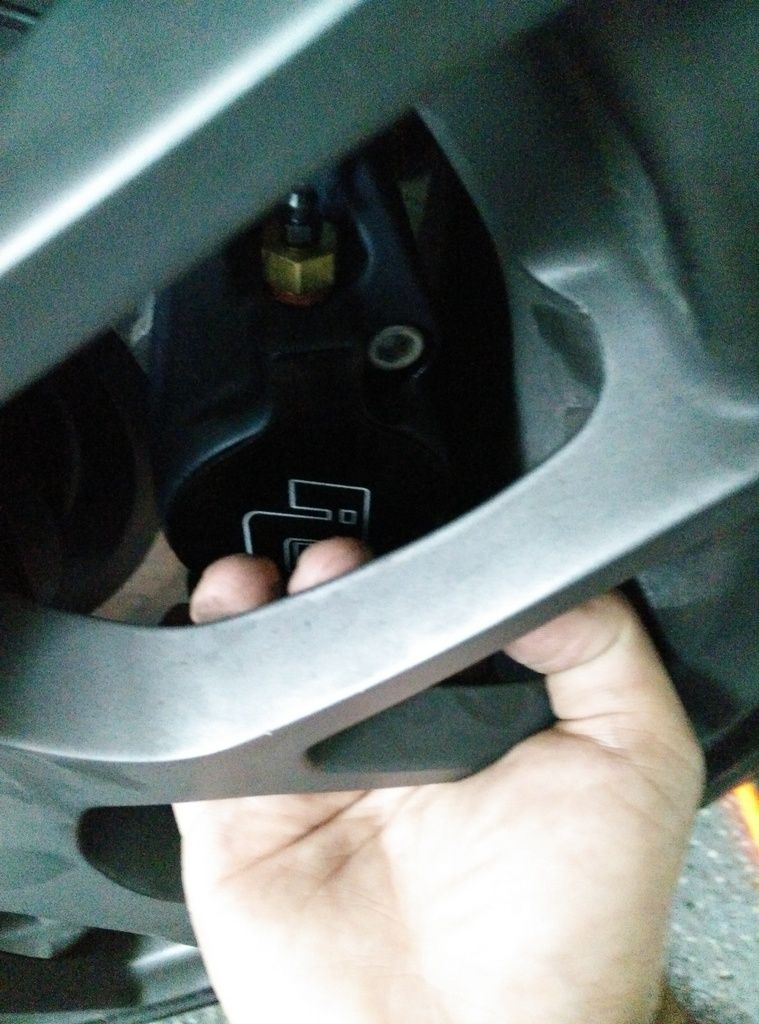

So I have had a loud clunk coming from both front wheels when I come to a stop or go from reversing to going forward, I figured that it was the end links being loose or being broken or something but I realized today that there is some play of the rotor on the hub as the PCD holes in the rotor aren't the same diameter as the studs... is this okay or are the impacts dangerous for those studs, also is anyone else having this problem or did I just get a bad set of rotors? :/

thats weird (and sounds sketchy as hell to me). my rotors had zero play and they fit right over my hubs just like the factory rotor hats did.

With the wheels on the rotors shouldn't even be able to move around, so it shouldn't matter if the holes are a bit bigger.

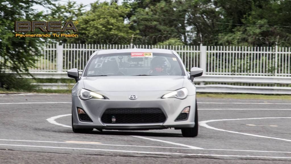

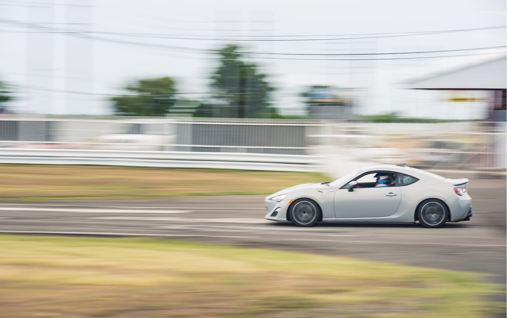

I'm in love with this kit, just tested them at the track at salinas speedway yesterday and I managed to get a full 2 seconds off my best time with fresher rubber and the BBK. The car slowed down so much faster and felt so stable and confident that I was pushing my braking zone farther and farther after each lap. My best lap ended up being 1:11.09 secs from my previous 1:13.0
In august I'll know exactly how much of an improvement the BBK alone had on the track I normaly race at where I ran with brand new rubber and OEM brakes with Raybestos ST43 pads. But between Salinas speedway and Ponce Speedway, we have a 20sec difference in lap times and my best time at ponce has been 1:32.28, so with the conversion, the kit by itself should have netted me a 1 sec improvement over the OEM system.
