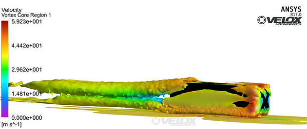

I can finally announce the very exciting information I wanted to share with you guys! It's fairly nerdy stuff but if you're an engineer, you've probably heard the name ANSYS thrown around. We are now learning and utilizing ANSYS for our CFD and FEA analysis!
Blog Post on ANSYS switch over
[ame="https://www.youtube.com/watch?v=ymjSNaqZLps"]Redbull F1's take on ANSYS[/ame]
Another blog post some may find interesting. It is in regards to the rear diffuser as our rear up-turned lip has a bit of skepticism associated with it as it isn't standard or common place. While learning ANSYS, we decided to conduct a simple analysis on a simplified car (Ahmed model).

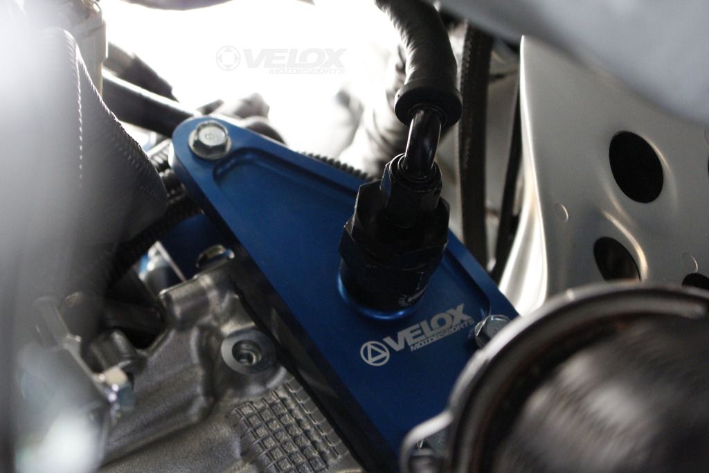

Prototype AOS automatic drain back is holding up well, finally took a photo of it.
Is this a cam plate? What's that line?
Yes, this is the cam plate. The line is an automatic drain line for the prototype AOS we've been running for a few years now. Finally coming to production. It's optional for those that want a service free kit.
