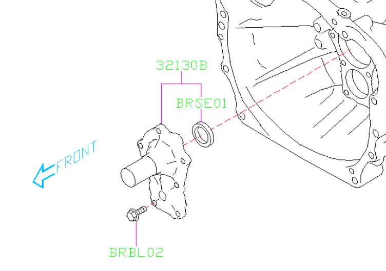

That's is pretty much exactly what happened to mine. Squeaky clutch pedal - they've tried fixing it by replacing the clutch master cylinder but it it obviously didn't help at all. It got worse to the point that it would sound horrible when coming to a stop after driving at high RPM.
Replacing the release bearing AND the sleeve was the solution, but as mentioned I got a whole new clutch out of the deal.
This is the sleeve if I'm not mistaken:
"RETAINER-BEARING " 30099AA040
They've added some lithium grease to it to hopefully prevent the same from happening again.

Originally Posted by sav View Post
-Release bearing R374.21
How long ago was that?
Your release bearing price is way less than Toyota's list price now (R641.87excl)
Maybe that's their cost price, being an internal warranty invoice?
Anyway, I got my car back an hour ago, and it feels great!!
Thanks AUTO UNLIMITED, you guys rock!!
A few clutch drops, some wheelspin, couple of WOTs to the red line, and nothing went bang.
I'm a happy camper.
