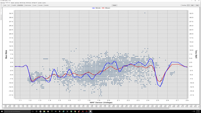

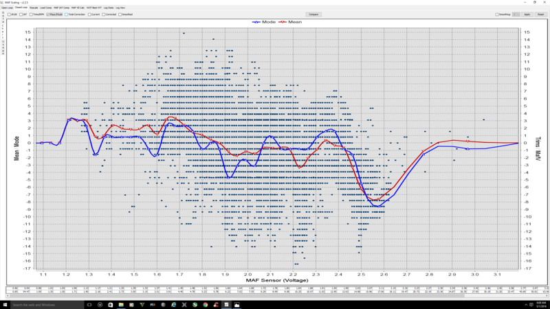

I tried to rescale my MAF. This is the log after my first maf scale
http://www.datazap.me/u/dru670/1st-m...=0&data=1-5-13
and this is another log after I did a second scaling of the MAF.
http://www.datazap.me/u/dru670/2nd-m...=0&data=1&hg=1
I was wondering what do you guys think looks better between the first and second Maf scale. I was told it takes a good 3 or more maf scaling to get it right but i'm wondering if it is getting any better or not so far.
Dru670 is offline   Reply With Quote

@Dru670 just check that the mean/mode graph is close to 0% and that the curve is smooth. The better the scale the grouping should get tighter.

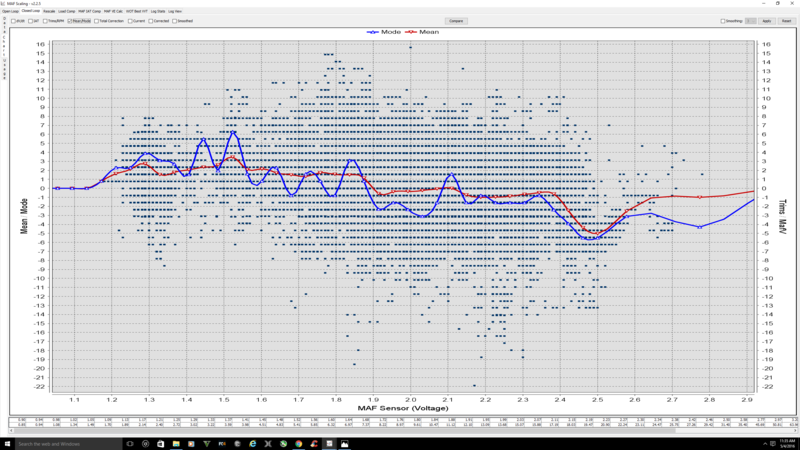

Would MAF3 be the better of the 3?
MAF3
MAF2
MAF1
