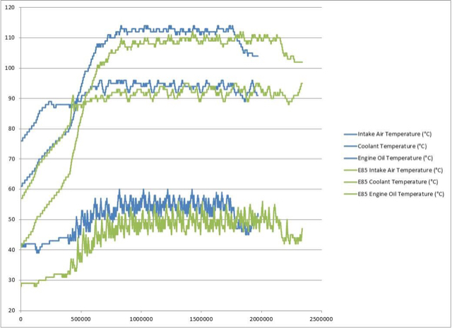

Originally Posted by NotSoJDM View Post
I posted this in the FB group, but I'll put it here as well. I went to the track over the weekend, and managed to get some more temp data. I overlayed the data from this weekend (on e85) with the data I took in November (on 93). Ambient temps were similar (around 65). The only difference aside from fuel type was the removal of the factory snorkel this go around.
Attachment 132208
Since the data is colored to differentiate fuel type, I'll go ahead and tell you IAT is the bottom curve, Coolant Temp is the middle curve, and Oil Temp is the top curve.
You mention an edelobrock fb group? whats it called? i just got my kit installed on my brz yesterday and would like to join
