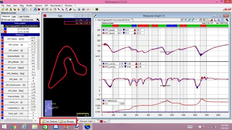

Only other issue I'm having at the moment is with the Test Database and Lap Manager tabs. When I was trying to setup my default view, I was resizing some of the windows I had opened and closed both the Test Database and Lap Manager windows. Ever since then, whenever I try to click on the tabs (highlighted on the image below), nothing happens and I cannot seem to open these screens at all. The only way I can get them to reopen is to restart the software. Any ideas?

Originally Posted by TCR View Post
Thanks Mike.
For Test Database, go to Data -> Load Test
If you load a test, Lap Manager will come up as a tab.
Old 03-06-2016, 03:39 AM   #74
TCR
Drives: 2013 Toyota 86 GT
Location: Brisbane, Australia
Posts: 56
Thanks: 14
Thanked 8 Times in 7 Posts
Yeah, tried that. I click on the Data tab and then Load Test from the drop down menu, the screen flickers (like it's opened) but the screen stays the same. The tab below is "selected" like it's open, and if I click on the Data tab a second time, the Load Test option is greyed out (unavailable). It's like it's opened somewhere but I cant see it. Even if I minimise everything I have open I can't see it.
I even tried deleting the software and reinstalling it.

Old 03-08-2016, 12:13 AM   #75
TCR
Posts: 56
Thanks: 14
Couldn't work it out, so uninstalled the software, deleted all associated files and then reinstalled the software. Seems to work ok now.
