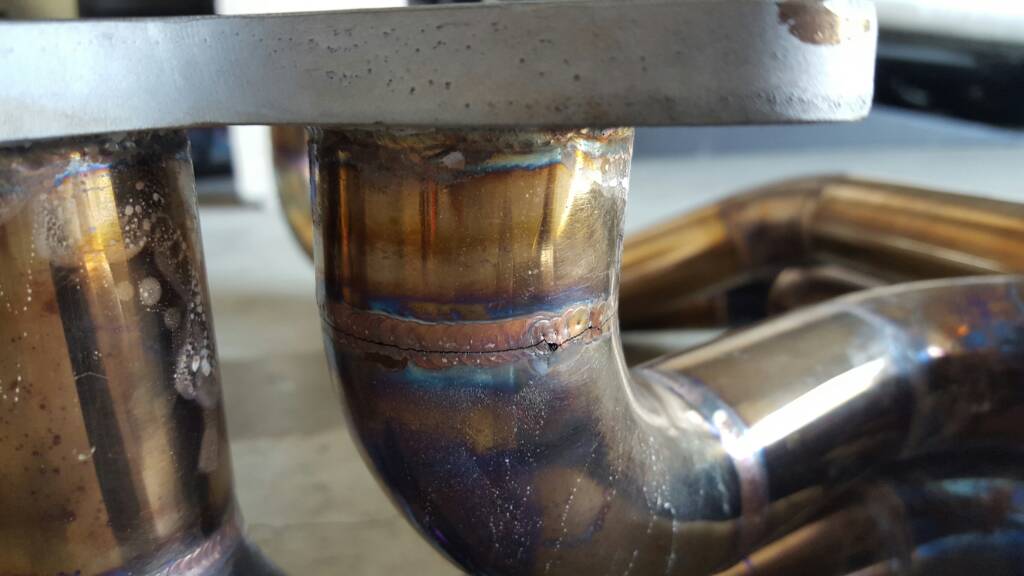

Been running my openflash header for about 6 months. All was well until about 2 weeks ago when I noticed a faint ticking noise at low rpm, high load. It's steadily gotten worse since then, and after replacing the header to op gasket (no luck), then trying to use copper RTV (no luck), I found this. I've been a huge supporter of openflash for a long time and expected better, which is why I started with gaskets. Has this happened to anyone else? Is there any kind of warranty on these?
@Shiv@Openflash
Here's mine. About 10k miles.
Attachment 135337Attachment 135338
Sent from my SM-G920T using Tapatalk
Damn! Is this a common problem with headers that don't have slip or flex sections?
-Josh
No,
That crack is from all those fish eyes. Google "tig welding fisheye" for an explanation as its not my place to talk about others welding practices however i don't want miss information to be spread as to why something would crack. FWIW there's pictures on this forum of what's regarded as a super high end header that's full of them too.

Originally Posted by JDLAutoDesign View Post
No,
That sure looks like a nice spot to grow a stress crack from. That's unfortunate. OP, does yours also show fisheyes? Hope you get it resolved.

My OFH cracked in the same spot. Mine was number 0020 from the first batch. Openflash sent me a warranty replacement. I sold it to another FR-S owner and he has been running with it for almost 2 years. I picked up the JDL UEL with flex joints.
