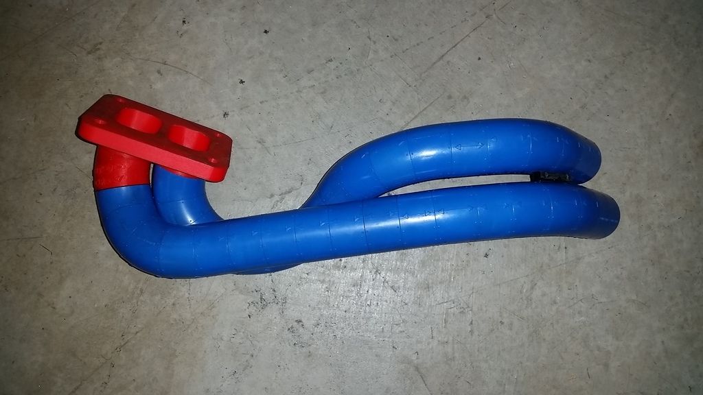

Just for you. Confirmation that the overpipe will fit. It's even equal length!

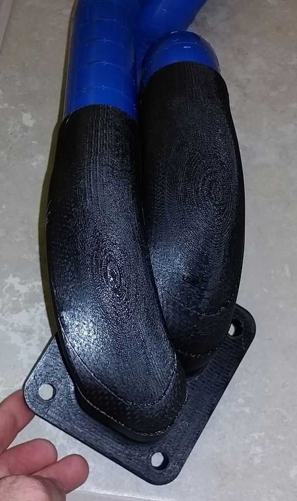

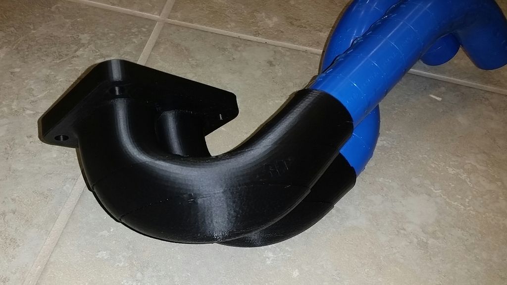

Working on a design for the tube to T4 flange transition. Going to have this part investment cast. Trying reduce turbulence into the compressor by having a gradual expansion through the bend rather than an abrupt transition right at the flange. This is the biggest part I've printed yet. Had a couple of instances where the print shifted a bit. I think the tension on the drive belt is just a bit too loose.

Do you use support material?

I do. This part needed a ton of it both inside and out. Really sucked to remove it from inside the runners. I think it would successfully print without any internal supports though. Prints like this are really tempting me to upgrade to a dual extruder so I can print the supports with a water soluble material.

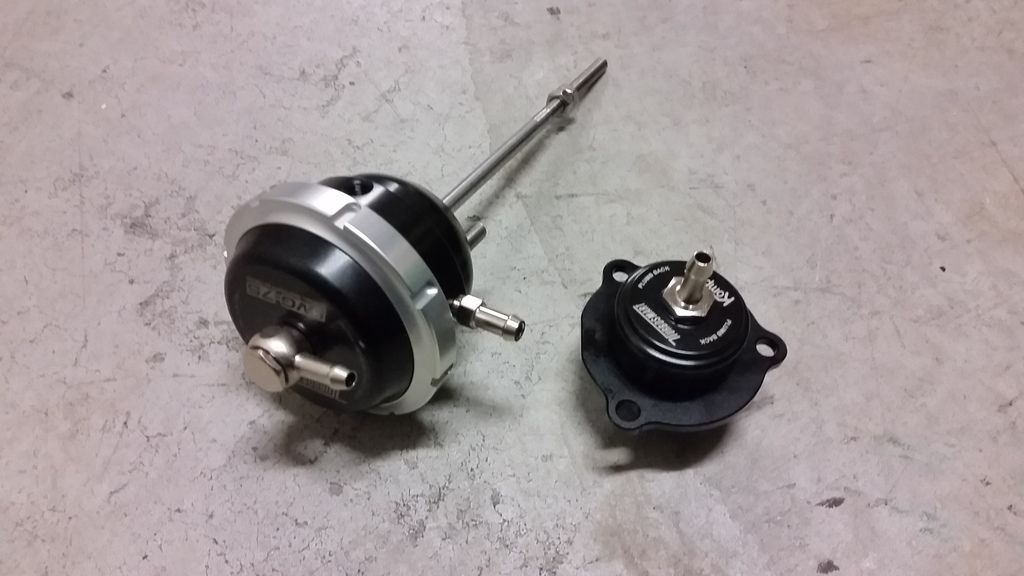

Sorry, not much for updates. Just got home from a nice 10 day ski trip in Colorado. Why did I have to come back home to work? Will be traveling for work the next couple of weeks as well so probably nothing new for awhile. I have been talking with a few casting companies about the above part getting quotes and design suggestions to help with the casting process. Hopefully I can finalize that soon. I did get some presents in the mail today though..

Now I want to get one of those for my 7064 efr! Glad you went the EFR route. Can't wait to finally see some dyno numbers one day!! Keep up the good work!

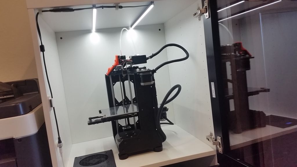

On a side note I build a really cool temp controlled encloser for my 3D printer today. Its really just pieced together Ikea furniture with a fan controller, led's, and added structure so the printer doesn't shake it apart. But I'm pumped on it. Now I can run my printer even more without my girlfriend getting irritated with the noise in the kitchen.
