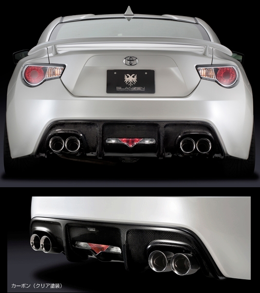

Custom Carbon Fiber rear bumper + diffuser! For Quad Exhaust! Need a company/shop!
Hey guys, to start off I'm planning to get the
BLITZ Nur-CTi Quad Exhaust
Took these pictures in person at a retailer
This exhaust won't fit the stock rear bumper for obvious reasons.
I'm trying to find a pre-built or custom made carbon fiber rear bumper + diffuser that will fit this exhaust or be made to fit. I'd rather have a custom rear diffuser than to re-weld the exhaust to fit.
This is kind of the idea of what I'm looking for.
Seibon TB-style carbon fiber rear lip
Sadly, this diffuser doesn't fit the exhaust, I asked Seibon if they can create a custom one with bigger spots but on their website they state for custom orders there must be at least 20 items for it.
I love this Varis CF diffuser, it's made for dual tips but if it could be recreated for quad tips it'd be amazing.
Anyways, that's the idea. I've been trying to find a pre-made carbon fiber diffuser that will fit the exhaust and had no luck. I'm perfectly okay with going the custom route as that would make it even more unique. I don't know a lot of places that can do this sort of work. I contacted Wasp Composites but had no response, I also contacted Driveway Labs but I believe they only have diffusers.
Yes I have considered the TRD diffuser, but I'm looking for Carbon Fiber, or some elements to it. If there is a carbon fiber version of TRD diffuser then I'll definitely consider that as well.
Can anyone help me out and point me in the direction of some companies? Or shops? (Located in SoCal, willing to drive north.)
Anything helps, been trying to work this thing out so I can get my hands on the exhaust already, Thanks!

Wait, why don't you want the Blitz diffuser that's made for this exhaust? I'm pretty sure Bulletproof Automotive can get it for you as a package.

It's going to be 1000 times easier (and much cheaper) to make the exhaust fit the opening than to modify, resculpt or have a custom diffuser made to fit the exhaust.
TRD also makes stick on quad pieces that go ontop of the factory rear bumper's exhaust cutouts to fit their quad exhaust. If I were to start making a diffuser I would start with thoughs, get them positioned and then fill in the rest.
So I could get an already carbon fiber diffuser like Seibons, and take the exhaust to an exhaust shop to re-weld to make it fit? Would that be easier? I'd want to take it to a pretty good exhaust shop considering this is a high end exhaust..I don't really want to mess with re-welding when it is already pretty good factory. But if it's the only way then I suppose.
I don't know much about re-welding, adding piping, that much to be honest. Or carbon fiber fabrication, besides that there's vacuum and another method.

Someone on the forums has the exhaust with the TRD rear bumper fitted just perfectly. I think it was woookie

I said earlier on the thread, this fits Japan TRD, not US TRD, that's what I was told by a retailer
I believe Wookie got the Japan TRD which is why it fits, and I'm not sure if he asked Blitz to custom fit the exhaust into the bumper, feel free to correct me btw Wookie.

There are two versions of the exhaust you want:
model 64133 fits the JDM (and probably USDM) TRD rear bumper
model 64127 fits only the blitz rear diffuser
If you are not going with the blitz diffuser then you want the first model, more compatibility with other diffusers.
TRD is not CF, blitz is only partially CF. Silk Blaze makes a CF version, would probably fit the first model.

@kbye is correct.
I wanted to get the Quad tips on the TRD rear, but didn't feel the TRD quad axle back exhaust was worth the $$$. I contacted Blitz and they said they could produce an exhaust to fit the TRD rear bumper. They have the original one with 114.3mm large tips (which is perfect for their Blitz diffuser), and they then created one with 100mm size tips to fit the TRD Japan kit. The tips are not the only difference between the two exhausts, if they changed just the tip size, the two would be very far apart. So the area where it "splits" into the two ends (on one side) are closer together to accommodate for that. This exhaust was built ESPECIALLY for that rear TRD bumper.
After researching a ton, trying to fit one manufacturers quad exhaust, to another manufacturers quad bumper is pretty much impossible, unless they specifically made it for it (like MXP makes one just for FR-S RS 1.0) and (Blitz making one just for TRD). I see you like the Seibon TRD replica rear. If you get the BLITZ exhaust that is the 100.3MM, it should fit, since the Seibon one is a direct rep of the TRD, but in carbon.
There are many other companies in Japan that make a quad just for the TRD rear bumper. Every company designs their exhaust and can set it as far left/right as they want on each side, and then they shape the rear bumper to it.
Here's mine fitted:
If you don't like the TRD rear bumper cover, your best bet is to buy an exhaust + diffuser combo.
If you like the TRD rear bumper cover (or an exact replica of it that's made in full carbon or partial carbon) then the following exhausts are made perfect fit for it:
Blitz NUR-SPEC C-Ti Quad Part #64133
