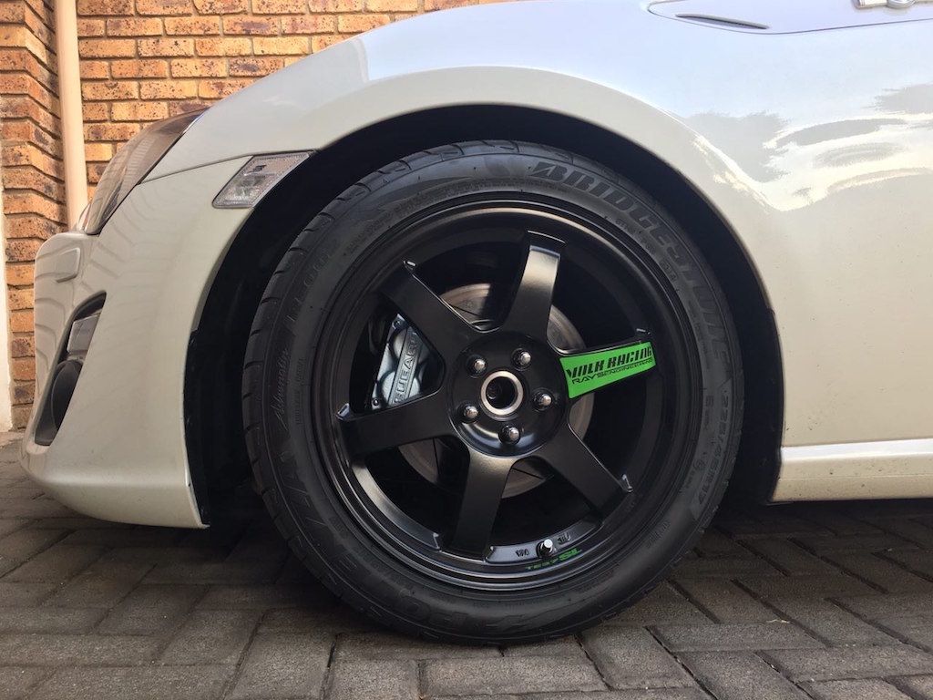

Got these today
Heavy Breathing...I mean Braking....

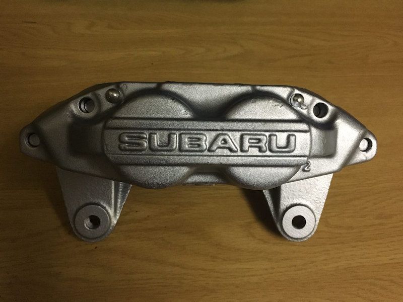

So here's what I've done:
WRX 4 pot calipers which is the same as what came with the Skyline GTR R32/33, Nissan 300ZX, Mazda RX7 and believe it or not, the Toyota Landcruiser, Hilux, etc.
If you get the ones from the WRX it's a straight fit, I've got a full set including the aluminum 2 pot rears but they're unfortunately not a straight fit.
Looks like this:
I didn't get the "hardware" with them so had to get 3 retaining pins from one Toyota dealer, 1 from another and the rest from Subaru.
No dealer have got stock but some of the parts are at the warehouse, the rest will be ordered from Japan. A bit worrying when a dealer can't supply a safety critical component in reasonable time.
To say they've made a difference would be an understatement. They're phenomenal!! They will make your eyes feel like they want to pop out and that's even before ABS kicks in! Well worth it...

I assume that caliper only fits the high-spec front disc size, not standard spec?

That is a good question actually. I've got no idea?
Yet the high and std have the same calipers out the box - wonder how much different?

Only the center part is the same, the bracket is different. With the WRX fixed caliper you can't swap them out so you'd have to get bigger disks I'd assume. Which of course is not a bad thing ...

Your PB discs, what size (diam) are they?

294mm I think.
This means you'd have to upgrade to bigger disks to fit the 4 pots.

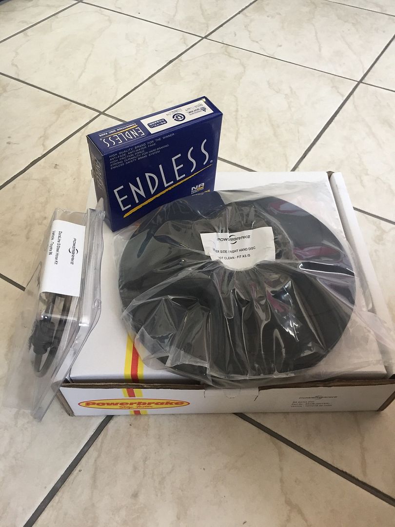

Today I decided to lay in a set of spare brake pads.
I'll soon be changing to some unfamiliar pads, so I'd like to have a backup for July's Michelin Cup event just in case.
