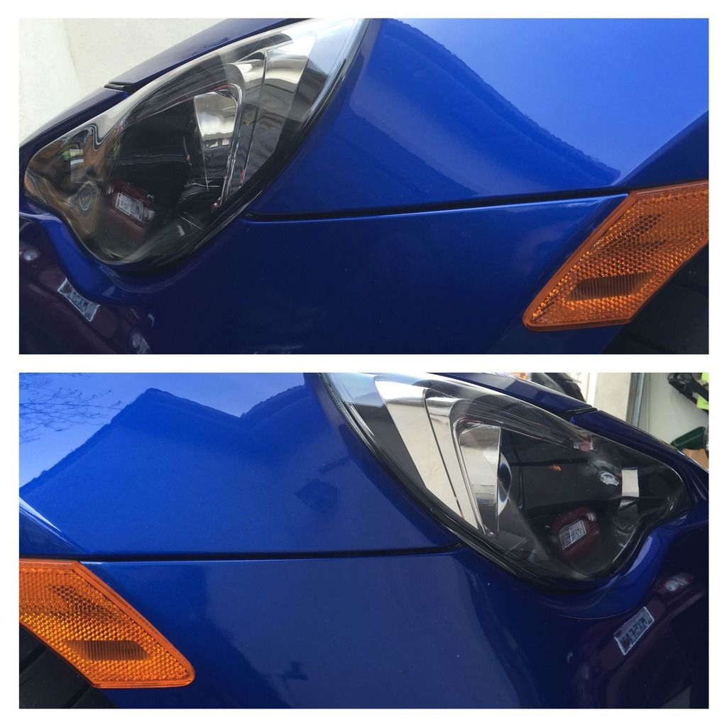

Messed with the piping some more last night. This is as close to having the bumper not pop out.

I can't even tell if there is an issue in those pics.

Yeah. I think I'm good right now. I'm pretty sure I just have more gap than before (understandable as the bumper had been taken off a handful of times) but the bumper not popping out means that the piping isn't rubbing with anything.
