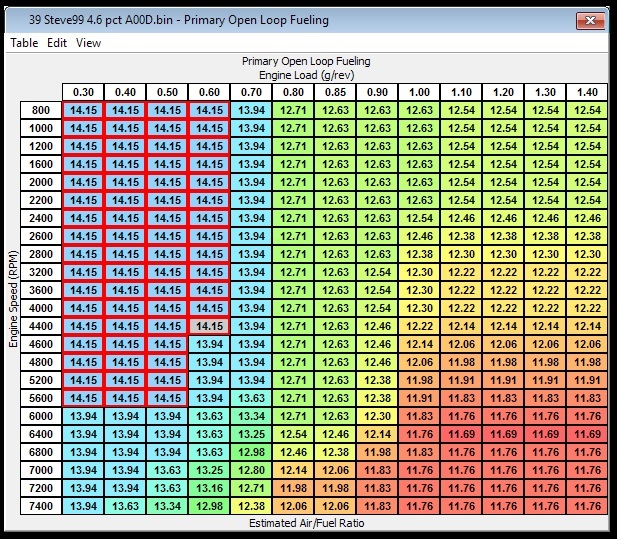

Target AFR 14.15%
Here in WA it's up to 10%. Especially in winter. My favorite station uses ethanol year-round though, so I'm changing my AFR table to 14.15 in the lowest sections, instead of 14.70. I also changed the BRZ port scalar 4.6%, since that was about how far it was off in CL. I know it gets the best mileage when it is just the tiniest bit lean in OL, so 14.15 should be a good target. This is the only table with AFR ratios I could find. It's an Open Loop table, but I think it is referenced for Closed Loop as well. See pic for more info. @thambu19, I only changed the 14.70 cells, or do you think I should re-scale the whole table 3.7% richer

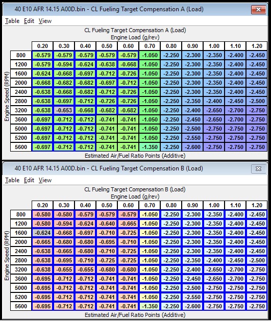

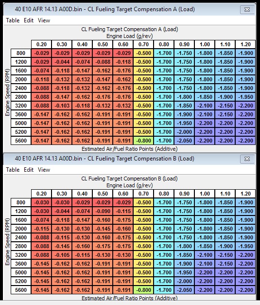

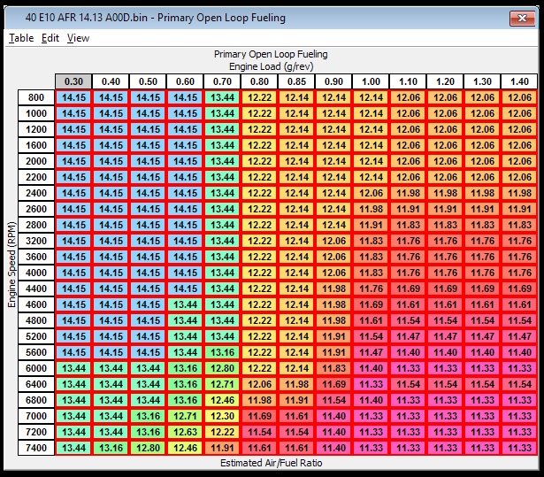

OK, this should do it
Here are my re-scaled Open Loop and Closed Loop tables that should bring my AFR down to 14.15. I just added .55 to all the cells in the A and B Compensation tables. I'll load up the tune and try it out this morning before I do my transmission fluid service/refresh, since I need it up to 42 C to measure correctly.

Old 12-12-2015, 07:10 PM   #236
KoolBRZ
KoolBRZ's Avatar
Drives: Silver 2013 BRZ Ltd Auto 45,000 mi
Location: Vancouver, WA.USA
Posts: 965
Thanks: 86
Thanked 452 Times in 278 Posts
Mentioned: 60 Post(s)
OK. Got the comp cells to all be negative values, and took it for a test drive again. Here is a log I took, http://datazap.me/u/koolbrz/1st-e10-...g=0&data=1-4-9 @thambu19, is there any way you could create a table of recommended AFR's by Engine Load and RPM's. I want to try getting my logs closer to stoich with the E10 I'm running now.
