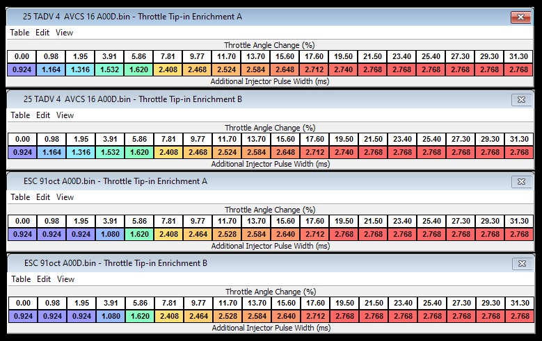

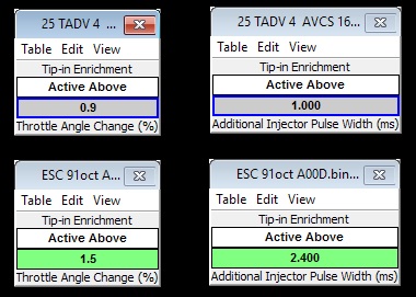

I have a totally different theory. I think the rich condition in CL is caused by sudden "Tip-in" enrichment, which affects STFT, becoming LTFT. This is then passed on to OL. I think Tip-in should have a lower threshold, and smoother transitions, so it wouldn't adversely affect fuel trims in CL, and then corrupting OL. It doesn't require any mysterious ECU reverse engineering, and it is a fuel source outside of usual channels unaffected by the MAF or MAP sensors. What do you think @thambu19?

Here are my current Tip-in thresholds above, compared to the OFT OTS map thresholds below. As well as my current Tip-in Enrichment A, and B tables, above, compared to the OFT OTS A and B tables below. I have tried smoothing out the transition between throttle angles 5.86%, and 7.81%, because there is such a jump there, but it didn't work as well when I drove it. So, I just stuck with smoothing the transitions under 5.86% and lowering the thresholds. Do you think the stock configuration of the Tip-in Enrichment and Thresholds could be the source of the problem?
