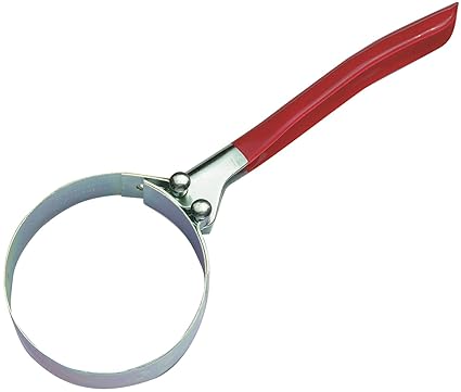

I got a filter wrench from fram! But no space to grip?.. what shall I do
http://ecx.images-amazon.com/images/...rL._SX425_.jpg

The OP found the solution that has worked every time for me.
Use a piece of sandpaper for grip.

If you really can't get it take to dealer for a $20 (or wahtever the going rate is) oil change special
Personally I know from past experience the first oil filter from the factory is like super glued on. I had dealer do my first change when they installed my spoiler. Did all my own since, never had a problem taking the filter off with my hand.

I'll try again...
Have you tried Sandpaper?
I have never found an oil filter that I couldnt remove with a piece of sandpaper used to get a better grip.
