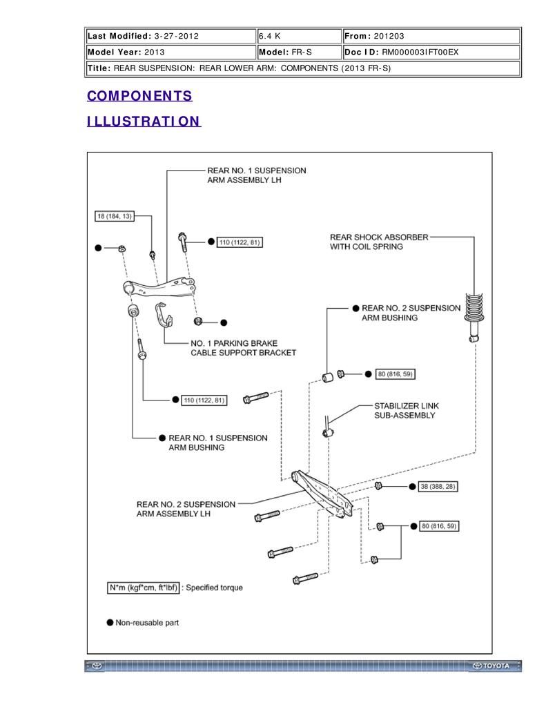

Originally Posted by solidONE View Post
Those torque specs look a bit low. Particularly the strut to knuckle hardware torque. Were talking about 19mm and 17mm hardware. They can take much more torque than 59 ft lb.
Did a little bit of research and found that 59 ft-lb is accurate. Below from Toyota:
Link to full suspension torque specs: http://www.ft86club.com/forums/showthread.php?t=92592
Ah okay.. he said "strut" so I got a little confused there. 114 ft lb for the 19mm strut mount bolts.
Although those 17mm bolts in there rear are plenty beefy to handle more than 59 ft. lbs.
