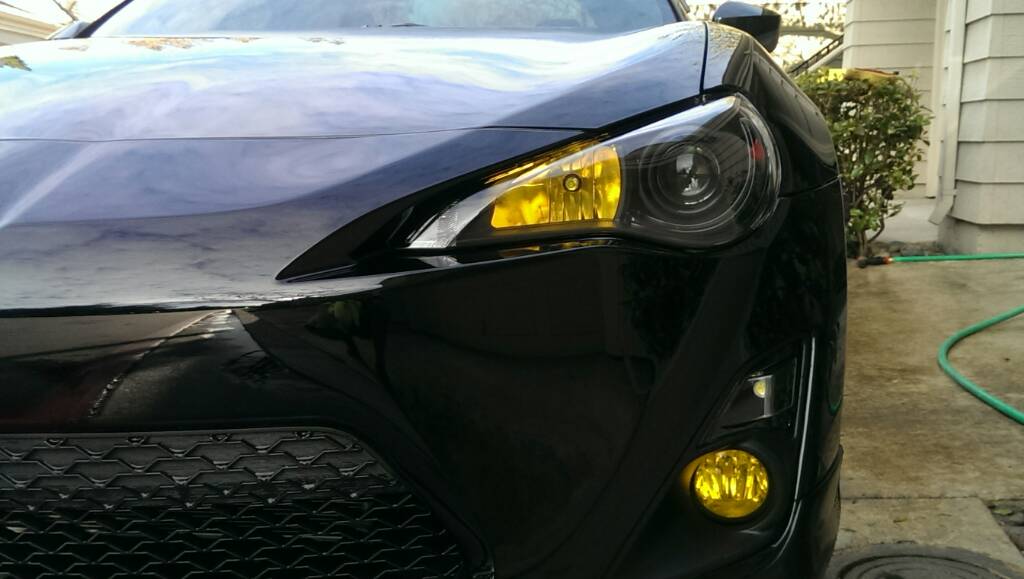

Originally Posted by ck-GT86 View Post
Updated my black-out last month, here's the latest edition: yellow inner reflectors for the high beam/DRL's. Blacked out the turn signals too
.ck
Attachment 69094
Sent from my HTC One using Tapatalk
Old thread, but what paint did you use for the yellow reflector??

This thread lead me to do my headlights and they came out perfect! I used the butyl tape that @ragequitfail said to use and it worked great. I wanted to paint the high beam reflectors yellow but couldn't figure out what paint to use so decided that I would just buy yellow lights later on.
