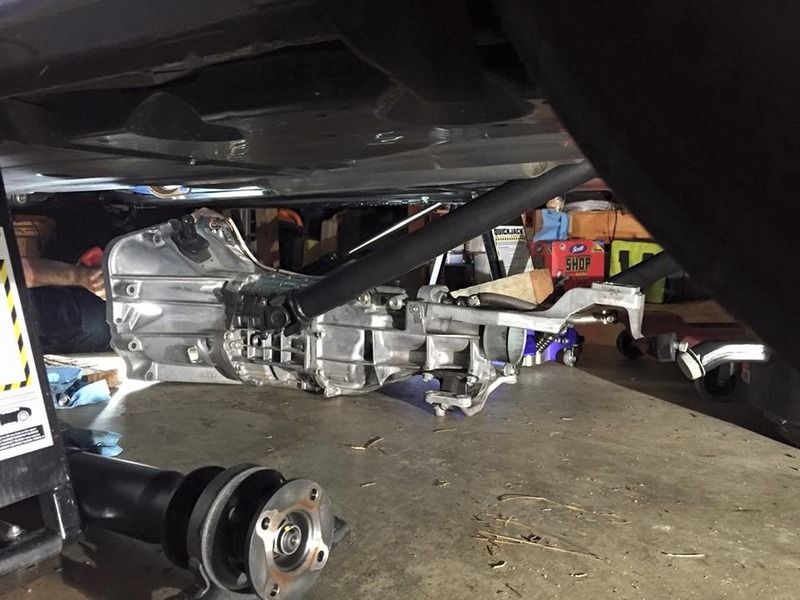

Installation:
Overall, it went smoothly. There's not really much to say about a clutch/fw install. My main comments would be that the dowel pins in the flywheel were pressed in nice and straight, and the pressure plate lined up perfectly. No issues with dowel pin alignment.

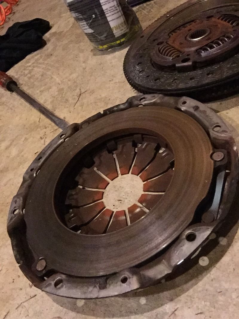

Old Clutch:
I was shocked to see the condition of my old clutch and flywheel. I have just over 66,500mi on the clutch at the time it was removed. Of that mileage, I have about 30 autocrosses (so about 120 launches), 4 track days, and a lot of hard driving overall. There were no hot spots on the pressure plate or flywheel, and the clutch still looked like it had some decent life left. With that being said, the reason I pulled it was to make way for the Edelbrock setup since it will inevitably make more power once its tuned.

The new clutch looked nearly identical to the old clutch, with the exception of the red pressure plate. In fact, they looked so much alike, I had to look at the discs to verify the part numbers were different as they were both Exedy. They were different =] Same goes for the flywheel, it looks just like OEM, down to the surface finish. So I didn't get any pics until it was all installed.
