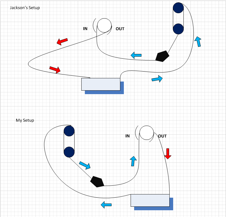

Originally Posted by ck-GT86 View Post
Hey All,
I rerouted my lines because of my Radium catch cans, so the oil reservoir is on the other side near the battery. Attached is a very rough drawing I made comparing the setups recommended by the install guide vs. how I routed the lines.
Attachment 121014
Does it matter which lines go in and out of the 10-row Setrab cooler?
Basically, the OUT line from the Rotrex dumps directly into the cooler, I cut the hose short since the location was so close. The oil cooler then pumps upwards to the relocated oil reservoir, which again, now resides next to the battery. From there, it feeds to through the oil filter to the IN on the Rotrex.
My concern is how short the line is coming from the OUT as compared to Jackson's recommendation, where the line takes a longer path before it hits the oil cooler.
Thanks!
It doesn't matter which way it flows through the Setrab, but you want the Strab post-supercharger, pre-reservoir.
