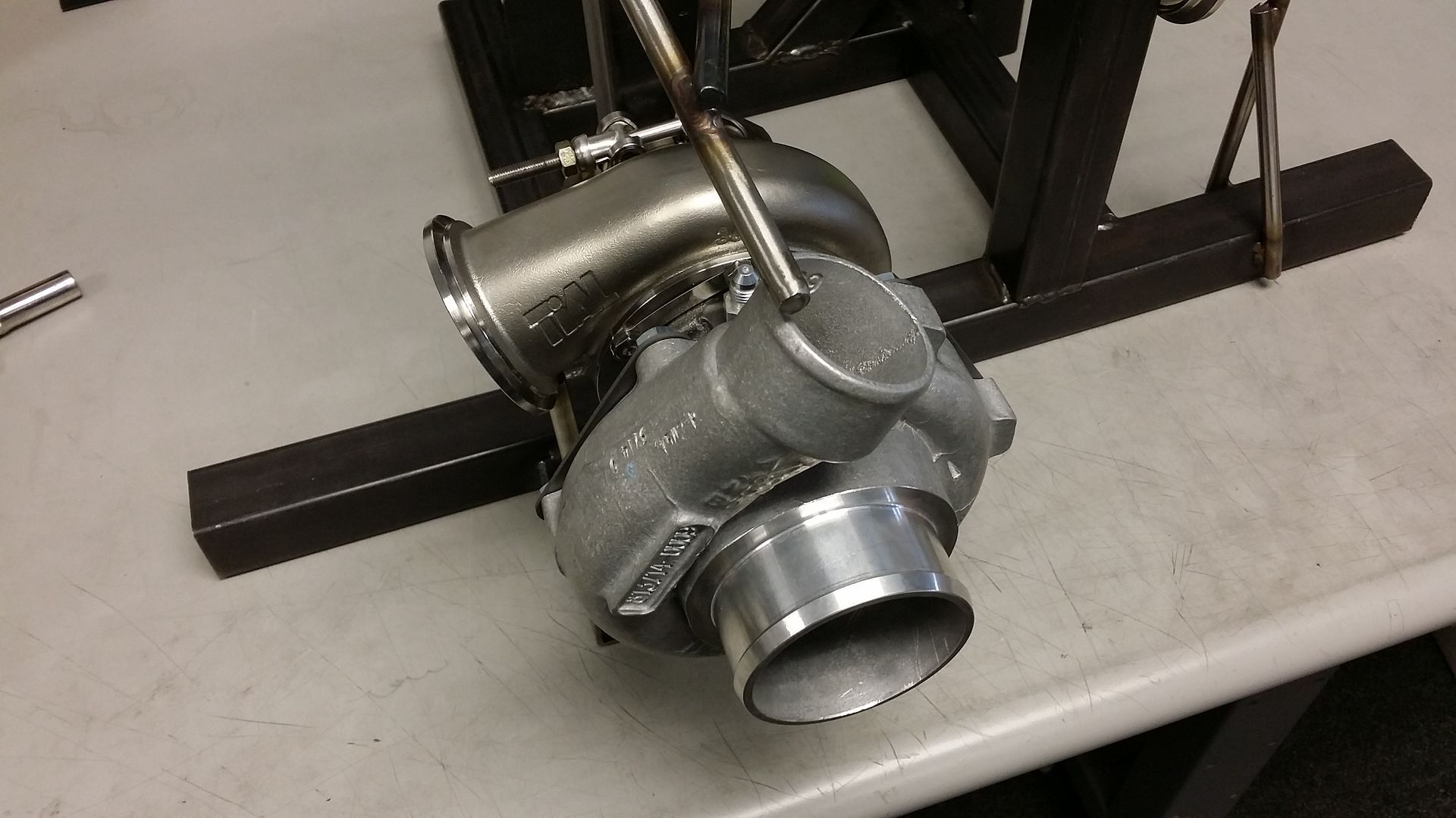

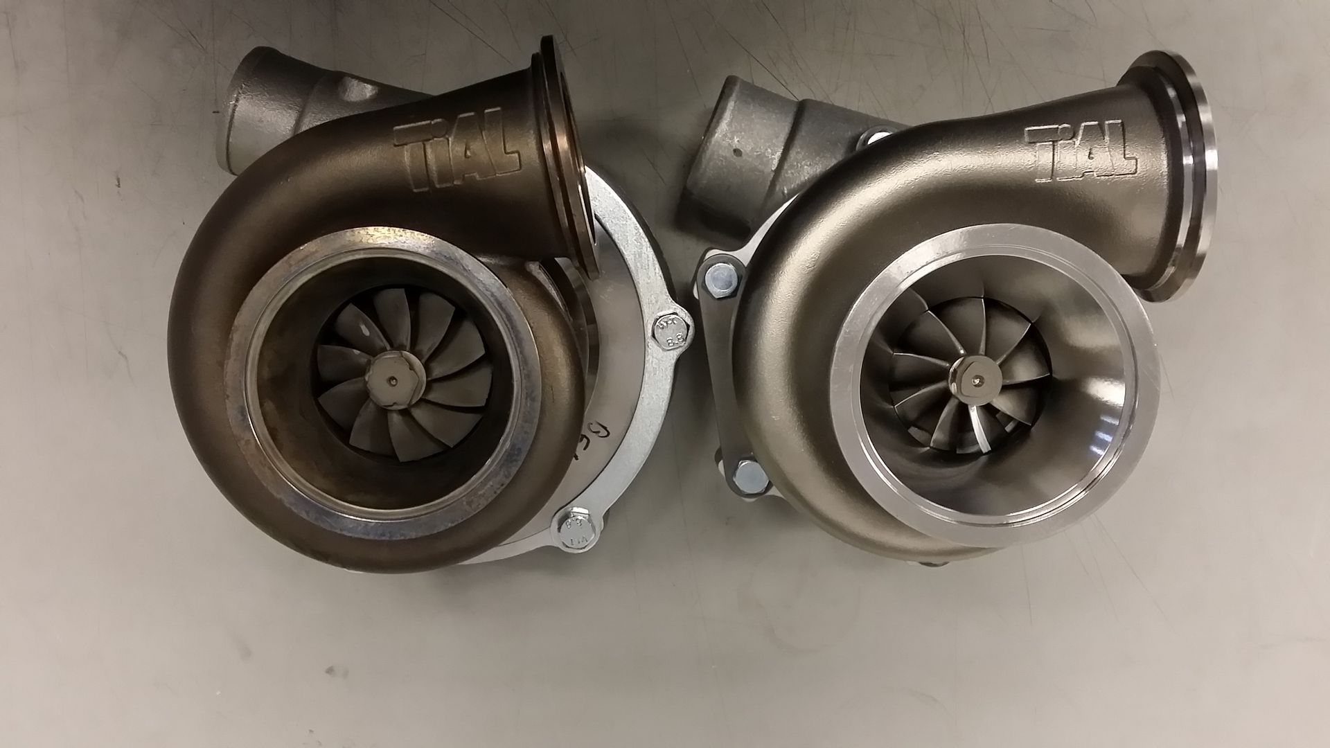

Did someone say GT28. Actually, we'll be testing the newer GTX2867R turbo shortly on the PTUNING FRS. This GTX28 is small and light vs the GTX3076R . I'm expecting big things from this compact turbo. We'll have some data shortly.
MrC
Clocking the turbo during the preassembly.

This may be a dumb question, but would this be compatible with the original system without modification? Interested in how this turns out!

That's a legitimate question. We are working on the details but as you can see, the compressor housing is much smaller in dimension. At a minimum, a different turbo to tranny support bracket and intake/coupler. The hotside in/out flange dimensions are the same, i.e. it will bolt directly to the existing overpipe, downpipe, etc.. All the coolant lines, turbo oil feed, return line are all compatible. We will eventually offer an install kit along with the turbo for existing owners that would like to try out a GT28/GTX28 turbo, if/when we decide to offer the GT28/GTX28 as an option with our turbo system.
