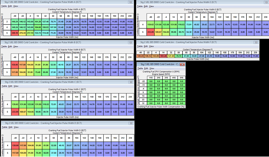

I'm doing the cold crank pulse width adjustments from the below link
http://www.ft86club.com/forums/showp...1&postcount=40
It talks about 0'ing out the IPW comp A table. Mine is already 0'ed out with a D00D ID but I was talking to another member on the B01D ID who has different values for the cells.
Does anyone know if this is correct? I made sure I have the correct XML definition file loaded. This is off of the 2.068 OFT maps. From what I can see as well the 2.066 map that I am currently running with no issues outside of cold starts has the table 0'ed out as well.
The below table is the stock 2.068 map just with the 1.2, 1.25, and 1.3 multipliers added to the a-f tables. I have not edited the IPW comp A at all.
Any input is appreciated!

Sometimes their are minor changes between roms or rom calid types or its just a cut\paste error, see what is a stock rom.
you tables look ok
wayno has done more work on those cranking tables i would grab his tables from one of the roms in his tune thread they will work better. will update the tune tweaks thread.
