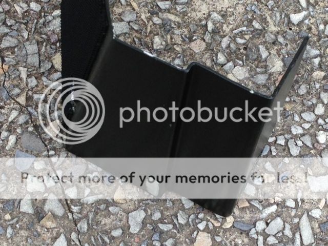

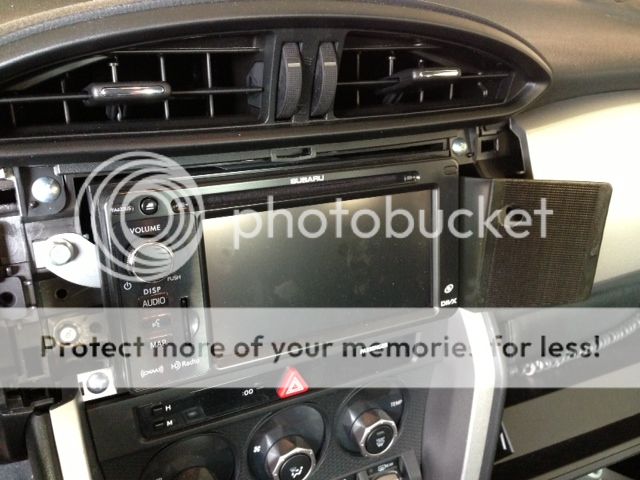

To be honest I'm not even sure. I got into it one Friday afternoon and messed up my first attempt while learning how to work the metal. I had to do a lot of trial and error. The aluminum will only fold once, so if you accidentally bend it the wrong direction it will snap when you bend it back. I started up again the next day and had time to let two coats of paint dry before mounting it on the car that Saturday night.
If you're going to try it, here are a few notes:
1. As I said I used 18 gauge aluminum that came in a small sheet from Home Depot. You can cut it to shape with regular tin snips. I didn't try it with steel, but you could if you wanted.
2. This is the seamer I bought at Harbor Freight, but it was on sale at the time for $8.99. I had to look at three pairs in the store before finding one where the jaws lined up. (If the jaws don't line up, they can cause crooked bends.) You might be able to do this in a vise, but it was nice to work the metal while sitting in my car so that I could see immediately what I needed to do.
3. Paint will not stick to aluminum unless you prime it first with self-etching primer. I used Rustoleum primer and matte black automotive spray paint from Home Depot, and it still rubbed off wherever it made contact with parts of the car.
4. You will see a large hole cut in the flat area where the phone mounts. That is there to allow for a socket on an extension to reach the mounting bolt. Without that hole, there is almost no way to get to that bolt. You could accomplish that other ways, but I didn't realize it until I had already blocked off my access to the bolt and had to cut the hole to be able to reach it.
5. The actual phone cradle is from an [ame="http://www.amazon.com/gp/product/B007FH716W/ref=oh_details_o05_s00_i00?ie=UTF8&psc=1"]iOttie One Touch[/ame] that I had sitting around, but you can adapt whatever cradle you have available. I mounted it with heavy duty velcro so that I could take it off if necessary. It's easier to get the dash bezel back on without the cradle attached.
Here are some more pictures:

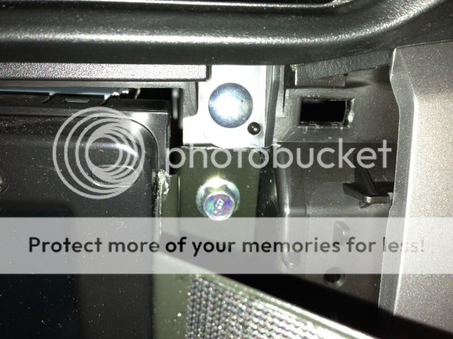

You can see that the paint rubbed off where I had it on the car and took it back off to take pictures of it. The paint really doesn't like to stick to the aluminum, but the scuffed bits are all hidden.
That's the mounting bolt I used. If you look just to the left of the bolt, you'll see two right angle bends very close together to let it lay flat against the head unit. You won't be able to get the dash bezel back on if you don't do this, but it was the hardest part to get right. It looks like the metal is crimped there, but that's just where the paint rubbed off.
A bit closer shot of the final install. You can't tell it from the angle of the photo, but the last bend actually tilts the phone backward slightly so that it's facing up toward the driver. You will have to guestimate that angle. To get that angle on mine, I installed the half-finished mount before making that last bend and cutting it off, so that it was just a long strip of metal sticking straight out from the dash. I then used a small carpenter's level to make a vertical line on it with a sharpie and eyeballed the angle of the bend using the vertical line and the dash itself as a reference. The sharpie marks were all painted over.
Good luck!
