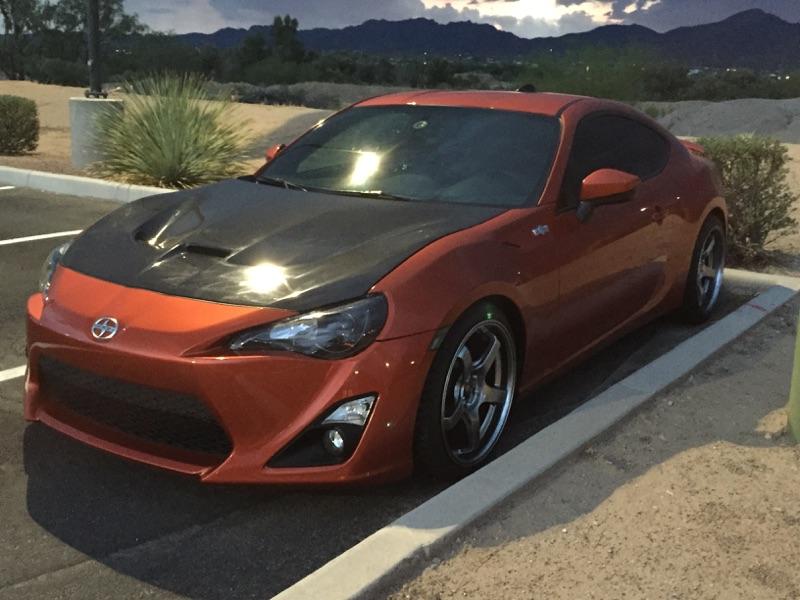

I went with the top secret hood, two vents and one small scoop right in front of the supercharger.
One vent right on top of the airbox so I could remove the top and have it draw air from there and the other to help with getting air out of the engine bay.
I have a picture but it's saying it's too big let me see what I can do
Attachment 119270
Sent from my SM-G920V using Tapatalk
Don't you won't the vents further back?
It seems your setup draws the cool air out?

One is completely in the AiRaid Airbox so it really can't function as an air removal very well at all but it does provide a good spot to bring in further air, not quite as cool but probably not much worse than ambient. I also wrapped the box in heat tape as well as the tube hoping to negate as much as I could.
The second does get close to the charge pipe so it might have some effect but honestly the under hood temps to the touch and logging have dropped sometimes only as much as 5 degrees but when moving they drop considerably which is nice for that long highway drive home making sure things have cooled off.
I have not gotten the chance to test it on the road course yet, I almost had the chance last weekend but ended up busy working on and tuning a Land Cruise with an LS Swap.
