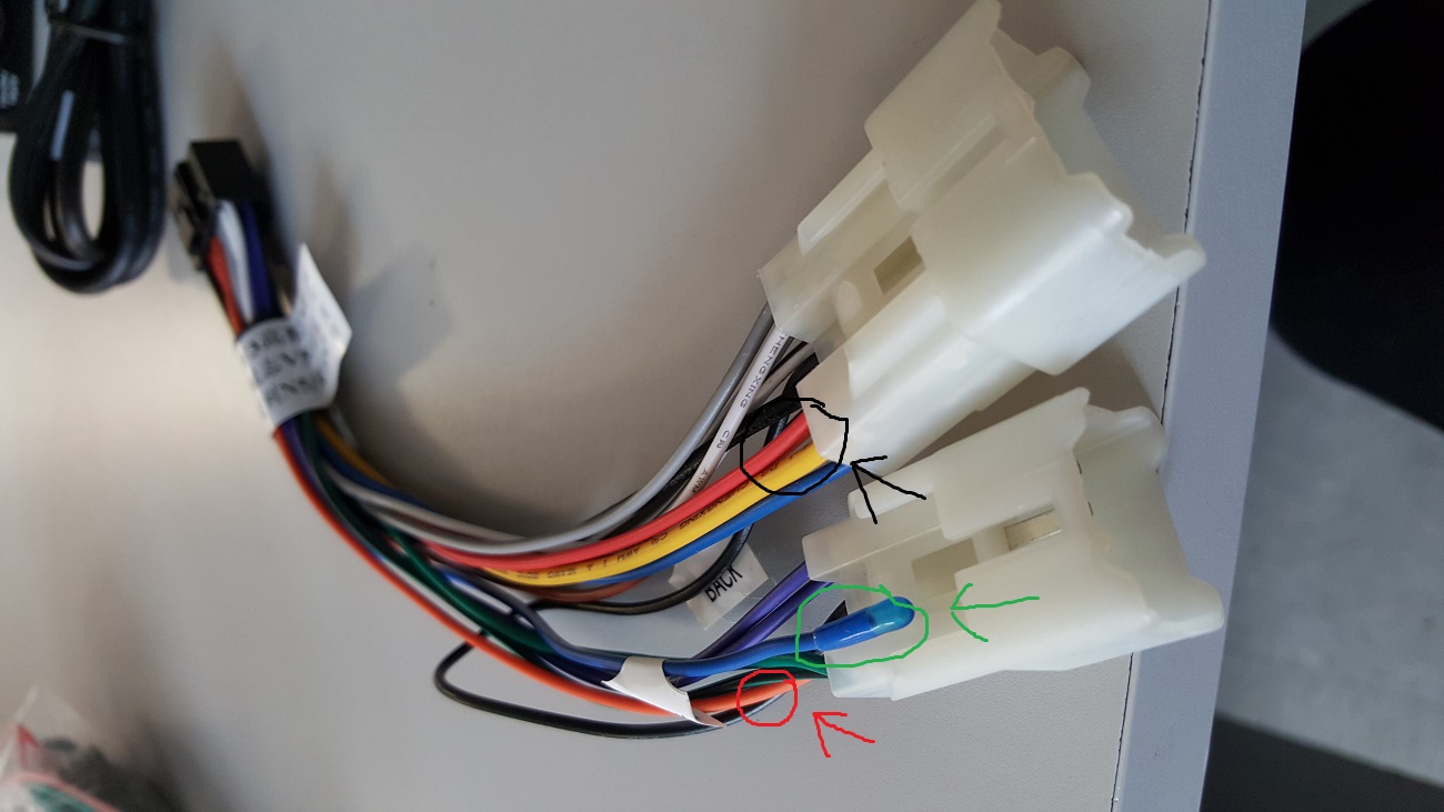

Hey, I know this is a super old post but I just did this, My door speakers still dont work
That means your car isn't getting a +12V amp remote trigger signal.
Did you look over CA-Fi's wiring diagram sticker and/or docs (if they provided any), or did you just do exactly what lamune posted? CA-Fi may have fixed the oddball wire colors that I mentioned in my earlier post.
If you're unsure what to do, you should post some good clear pictures of the harnesses CA-Fi provided, with all of the wires untangled and spread out so we can see the colors and what goes where, and a picture of their pin-out table (make sure all the writing is legible).
Anyone else who receives one of these HUs, would you please post good pictures of all the harnesses like that before you make any modifications?

Here are all the wires it came with. You don't need to use many. on the last picture with colors, the one with the red arrow I cut the orange wire out (if you leave it in your buttons will not work. fast fact you can program the buttons to do whatever you like in the menus if you want i.e. the gps button will go to home if you want), ignore the blue amp on wire in green, and hooked the brown oem wire (I think if I remember it was from pin 10 to the red one in the back area to get the factory amp on. I hope this kinda helps for now. Maybe I can redo this post at a later date and make it better haha!! I have a lot more knowledge on this now so ask away
