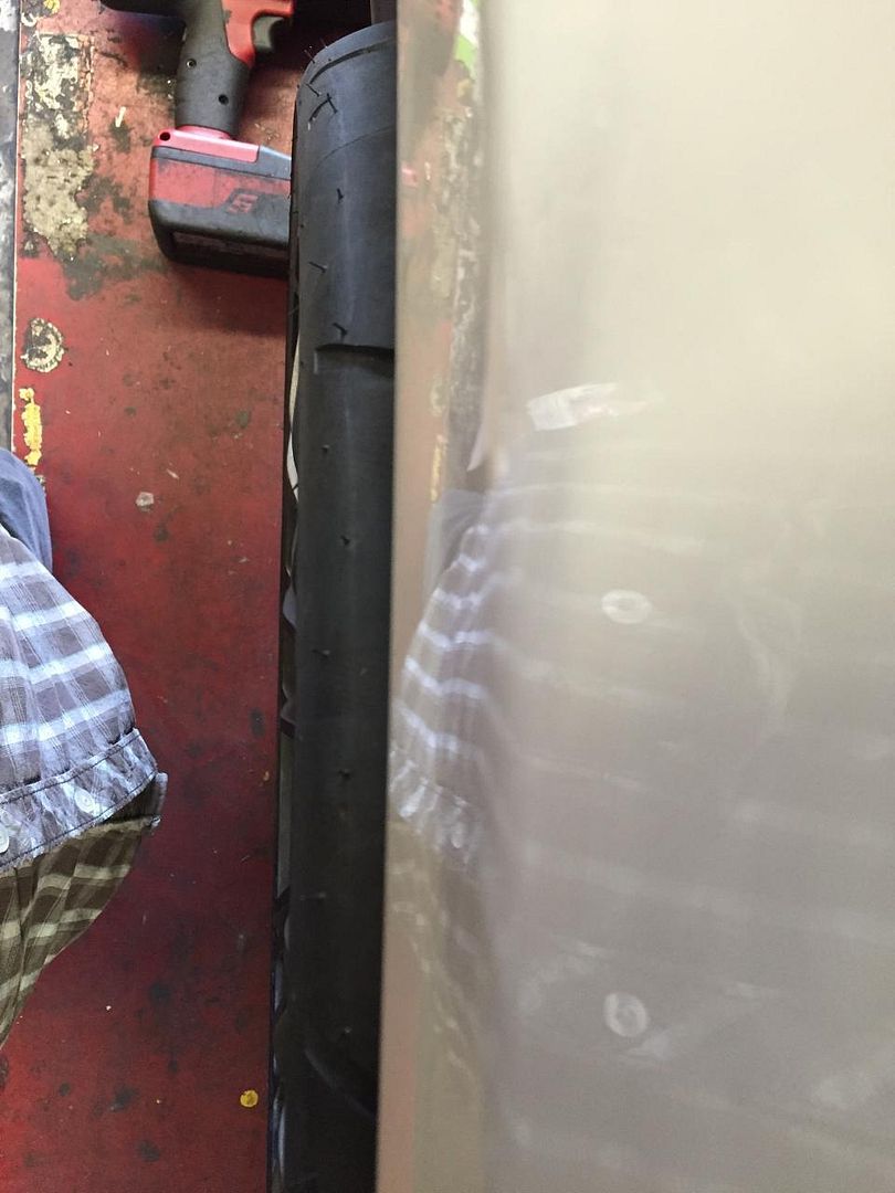

I tried to put r888 265/35/18 and it stuck out 1 in. running -1.8 in the rear. Rays 57xtreme 18x9.5 40+... Very disappointed it ended up on Craigslist the tires

Looks like you're at stock height? You're goint to have to be lowered to not have something like that poke out...

My car is lowered, it makes it worse at you correct camber after lowering the car.

I am just trying to show the different sizes between manufacture and even within it own company.

This is where doing your research first helps.
It's widely known R-comps run very wide compared to street tires. Look at the section width vs the "numbered" size of the tire.
For instance, I used to run 205 R888s on 8" wide wheel on the Miata, and lots of Miata guys run 205 Hoosiers on 9" wide wheels.

I was trying to show to the previous post about saying his setup working but different selection differ even within own brand.
I tried to do a search and couldn't find anything on 265 R888 so I thought I would try. At least it add to this search engine in regards to this setup.
