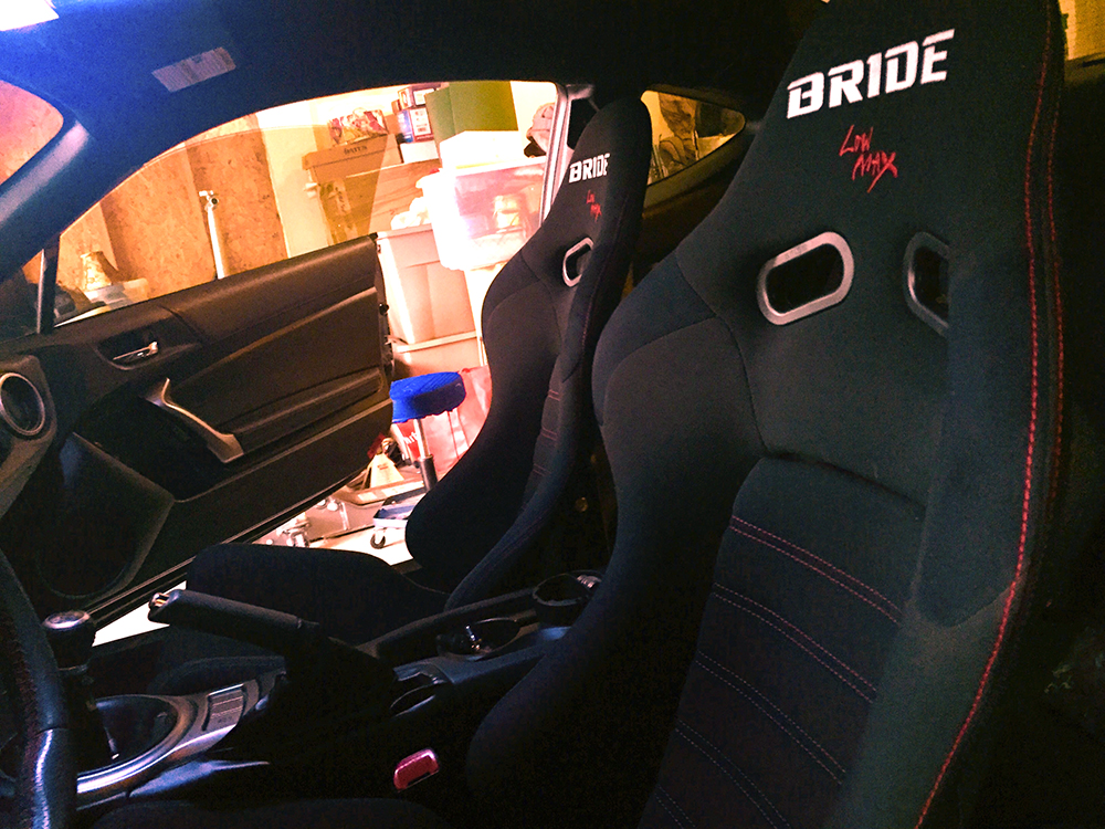

Have some news ! I installed my bride Zeta iii 's this weekend. Drivers side was previously done a year ago since I just replaced my cusco bride seat w the new red one.
Passenger side I used a resistor from bride which required soldering and also removed the occupancy sensor from the passenger seat and installed it underneath the cloth on the bride since you can remove the center pieces on the zeta iii bucket seat. I'm happy to report everything works like it's from factory. No need for a seat belt insert. No airbag light. Someone sits in it and airbag turns on and when they get off, airbag turns off.

just finished mine today, i tucked my sensor underneath my bride cushion and everything functions like stock!!!Name:  File Aug 23, 8 06 18 PM.jpeg

lookin good man!!
