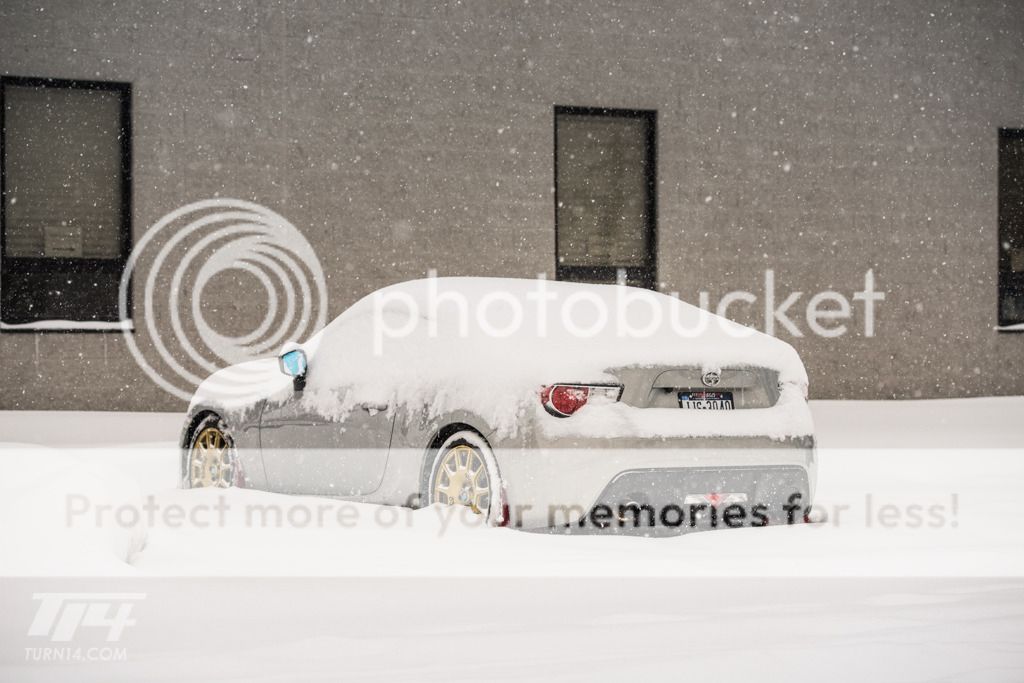

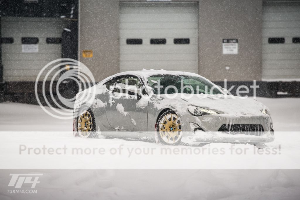

I drove my FRS all last winter. Ground clearance was an issue, even with my coils at the highest setting. A good set of tires, maybe some mudflaps, and paint treatment and you're set!

I would be willing to bet, that from the looks of the pic, ground clearance is a year round problem for you.
I thought I was pushing it with my almost 2 inch drop but daaaaamn.

Lol, you might be right! Its definitely something I have to be aware of.
