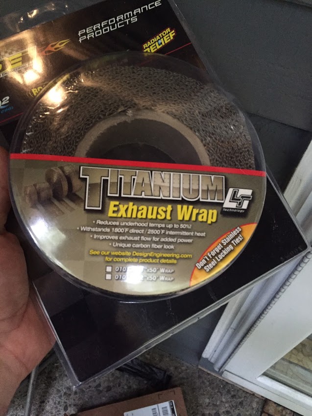

I recently received my HKS EL header which is currently being 2000F ceramic coated and will be wrapped, it will be mated to the Berk catted front pipe which I also purchased at the same time when I ordered the HKS..
I've never owned anything from Berk but overall it looks fine, I'll see how the fitment will be
