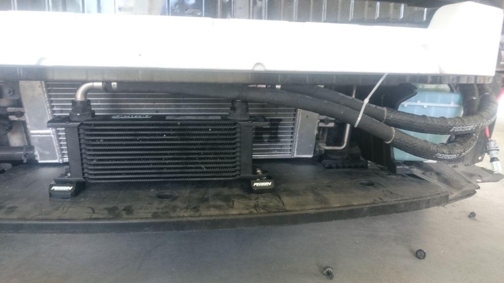

Originally Posted by ajc209 View Post
Did you mount the oil cooler directly infront of the cosworth radiator? pictures? :-)
Sorry for the delay, but here's how the oil cooler is mounted:
This is exactly what I came here for. Thanks man! Build looks great. I'm getting ready to mount my Perrin oil cooler in the next few days, and I wasn't sure if I could still mount it right in front of the Cosworth heat exchanger.
There's more than enough room to mount it. The Cosworth heat exchanger is super thin already. My only issue was fitting the thermostatic plate and screwing on the lines because of the air box being so damn close. Otherwise, it works wonderfully!
