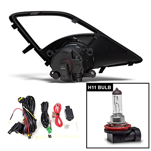

http://ecx.images-amazon.com/images/I/512qZxP09sL.jpg
these are the wiring kit that came with the fog lights ): they look nothing like the one in the video.. that's why im so lost right now..

http://www.fteightysix.com/appearanc.../#.VBO5KGMghrE
These are the ones I got and I'm having the same issue because its the same wiring. I'm assuming I'll have to cut the plug off and tap into ignition power?

Can you post pictures of the wiring harness you got with the kit??

These are obviously winjet fog lights.
Follow this video for the closest instructions.
[ame="http://www.youtube.com/watch?v=TiyAOksC9d0"]SPECDTUNING INSTALLATION VIDEO: 2013 SCION FR-S FOG LIGHTS - YouTube[/ame]

what i did was dispose of the wire that goes through the firewall of the car and just splice into the headlights so the FL turns on when i turn on HL which is fine with me

7:40 of spec d video... How did he get that control wire through so easily...?
Edit:
For me it was easier to route the extension wire from the cabin to the engine bay under the grommet. Rubber grommet is the only piece between engine bay and cabin... When reaching through it felt like there was some tunnel piece in between...

I know this is hella late but for future lurkers... Op's link look like winjet kit,
This helped me along with the links above:
https://www.google.com/url?sa=t&sour...ITIFzKyuiZIHPA
Edit:
Went to home depot, grabbed a few stainless steel 10-24 1" bolts, 10-24 wing nuts and a couple rubber washers... Got the idea from the diode video above and the thread sizes from another post on this site.
One of the spring nuts broke on me and I wasn't sure of the screw material provided in the winjet kit I got from amazon. Was able to mount the fog lights without taking off the bumper like a few other diy fog light installs.
