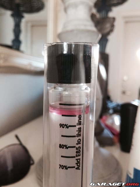

In need off some help
Went too my local tuner and tuned the car whit the ace 4-2-1 header full exhaust and 200cel cat.
And the car feels great and all, but keep getting the p0420 code, didn't get that code whit the oft E85 stage 2 map, so my question is how do I manually fix so the ecu dis regards the p0420 code as the original oft e85 stage 2 flash did?
And problem number 2 could starts, takes me at least 10times too start the car from could. Ones the car is heated it starts whit out problems, but it's nerv wreaking every time, when starting the car at race days, you don't know if it gone start and you gone make it too start in time for the race
Have the ethanol content something too do whit the bad cold starts?
Have pretty high e85 Content in Sweden, more like e94-e95 but the car I tuned for it.
Probably while telling my tuner what too do whit the mapping, but described it so even Opie in family guy would understand.

Yes you or tuner will need to disable cel code P0420 in the tuned rom. If the tune is unlocked then you can do it with romraider. You will need acopy of the tune from the tuner unless you have tactrix, as the oft will not read a second tune.
The tuner shoul also have increased th Cranking IPW tables for ethanol below about 20C you will need 30 to 50% increase at least.
see Tune Tweaks link below
