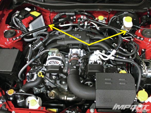

60 kg increase!! That's just crazy (in a good way). To think that 4 extra cylinders plus transmission plus a metric truckload of power only costs that much weight. Light weight seats, battery, wheels and bam! You're at zero gain.
Sounds mean too!
Can you tell us if there will be replacement bracing for the the indicated oem bracing shown in pic?
Ta.
