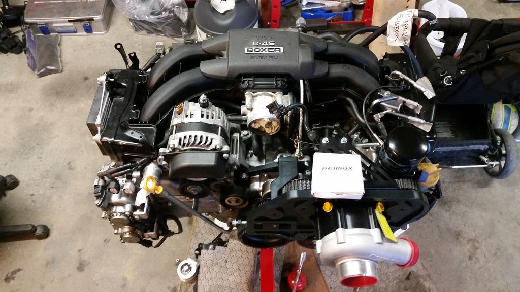

Originally Posted by Andreas83 View Post
The reimax pump gears are installed.
Installing the motor again soon.
Just have to figure out how to install all the new parts.
Supercharger, wasp splitter, massive skunk2 radiator with oil cooler.
Some of the parts and chassie needs small mods to fit.
I am also Installing a oil pressure gauge.
Any chance you could check oil pressures before and after you install the skunk2 radiator/oil cooler?
