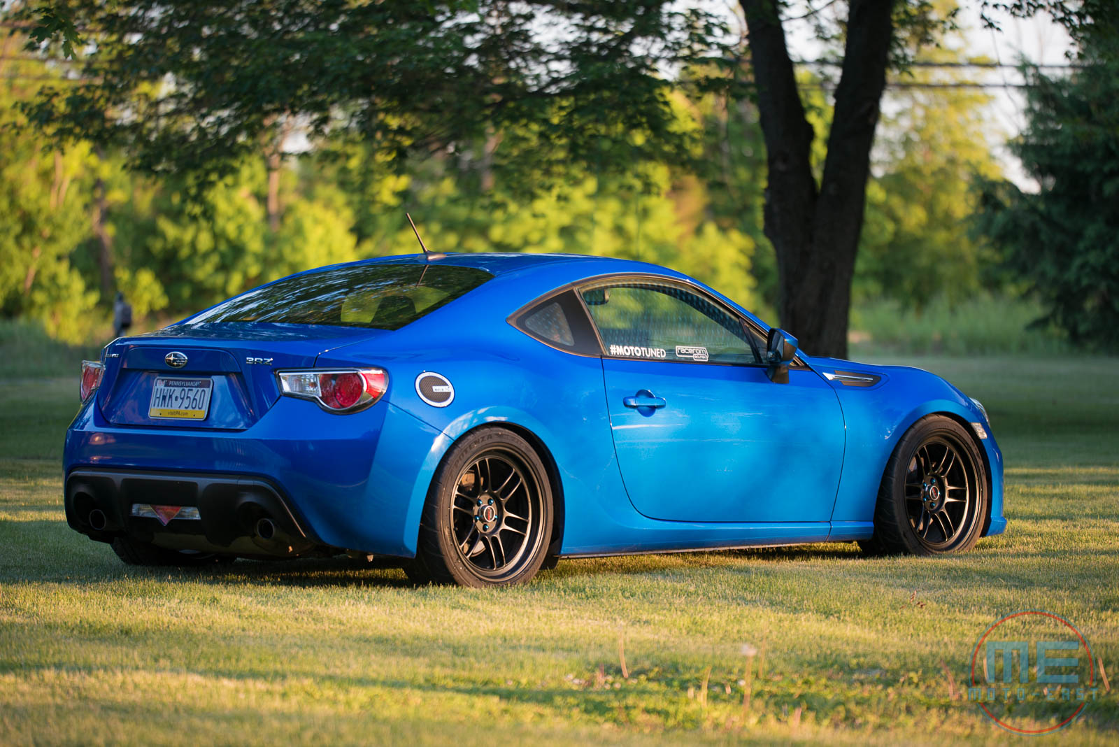

255/35/18 on 18x9.5, -2.8 camber in the front using Raceseng Cas/Cam plates, -2 in the rear with SPC rear LCAs. Just barely fits at this camber.
