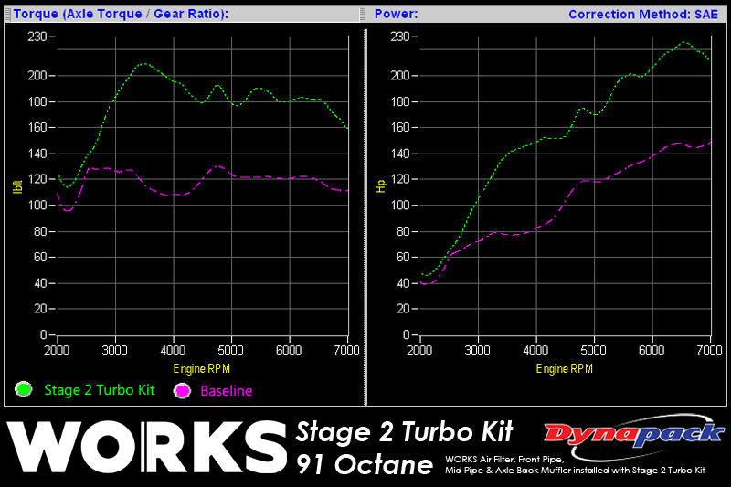

Originally Posted by stoked_on_spool View Post
numbers numbers numbers @WORKS! haha =)
Here you go.
As noted in the image, our WORKS Air Filter, Front Pipe, Mid Pipe & Axle Back Muffler were installed at the time of the Stage 2 readings.

Looking good WORKS. cant wait till cam tunes out my car. Here you go guys just in case you are curious.
