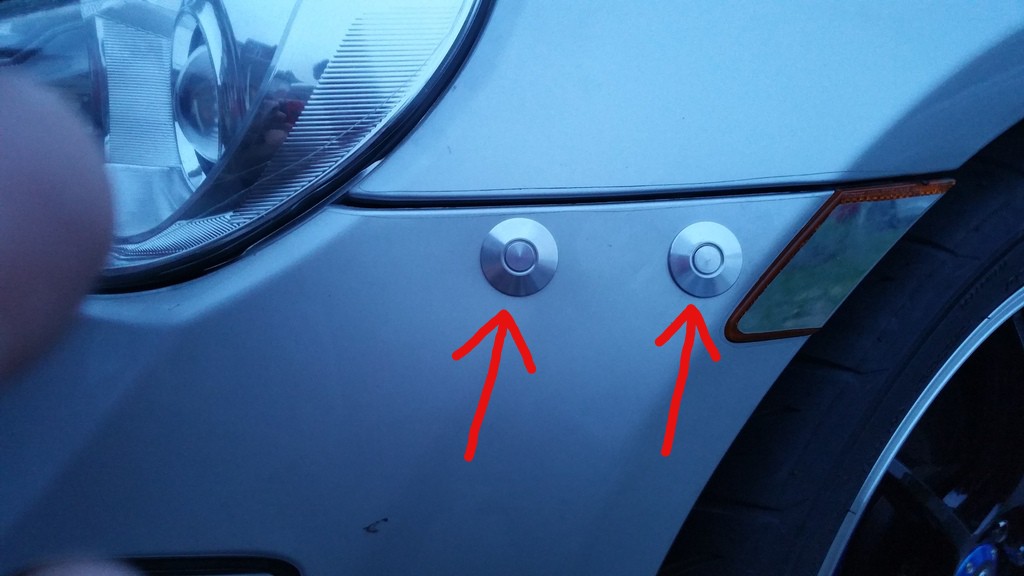

[QUOTE] Fixed mine today
I have to ask but did you fixed with that or im missing something? How you did it?

[quote=ricky rod;2261685]
Fixed mine today
Attachment 110524
Me no do - me watch do.
The angle line of the buttons is different than seen before, to prevent buckling and warping of fender, and the eventual inevitable loosening of that front mount (according to the engineer who did do).

Originally Posted by ricky rod View Post
Fixed mine today
Attachment 110524
Move Over Racing made a quick-release bumper kit that fixes the gap. It's expensive for what you get, though, and you have to drill into the bumper.
http://www.ft86club.com/forums/showthread.php?t=75057
Oh ok i got it now, interesting thanks for the info...

UNCLEAN! BRING OUT YOUR DEAD !
Stay far away from that P.O.S. rip-off kit. No or incorrect instructions. Extremely expensive.
Just get the Q/R latches and use your own washers and spacers.
