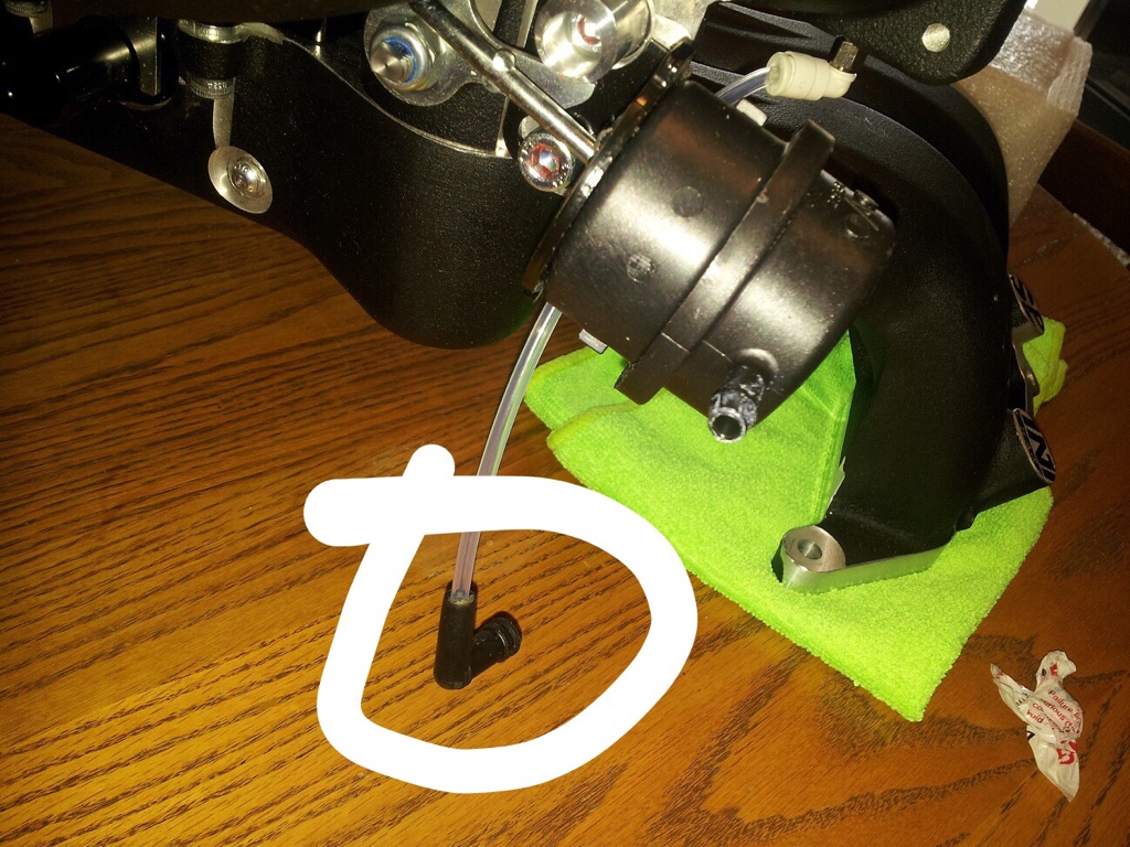

Hey @SprintexUSA where can I get another one of those little rubber elbows? (circled in the pic).Name:  ImageUploadedByTapatalk1432337899.891199.jpg
