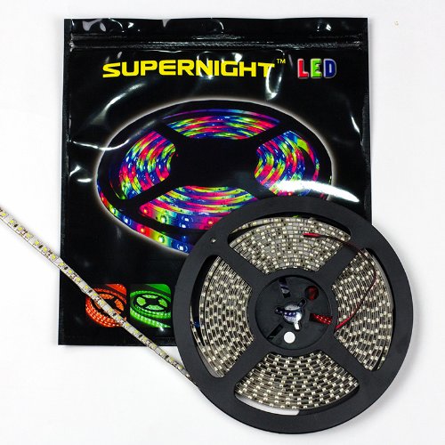

I ordered some mini high density LED strips off [ame="http://www.amazon.com/dp/B00BSNZV2U/ref=pe_385040_128020140_TE_3p_dp_1"]amazon[/ame]. High density just being a fancy term for a butt load (technical term) of lights per meter. 120 leds per meter I believe.
I planned the locations for the lights and cut them all to size and did a proper soldering and heat shrink tubing job on them.
