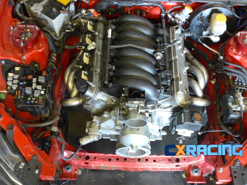

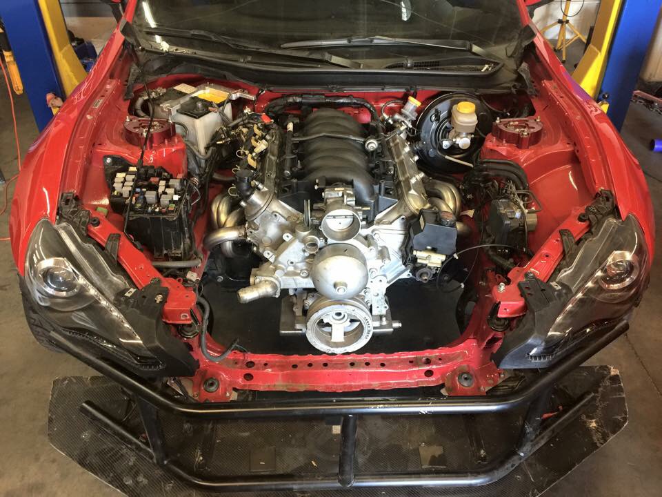

Check out these pictures CX Racing posted yesterday! Pictured is the NA header option they've designed for the carName:  ImageUploadedByTapatalk1430491669.217489.jpg

Glorious! I'll be waiting on your impressions on how the handling balance has changed.

Fits pretty damn well. Curious as to what the turn key cost of this would end up being?
