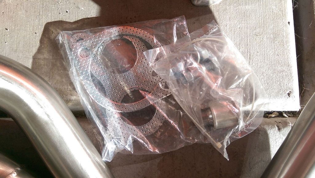

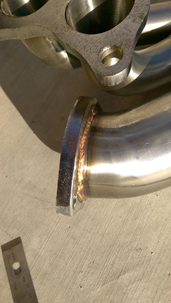

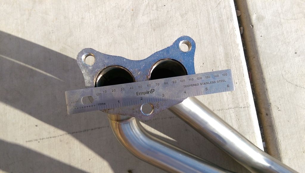

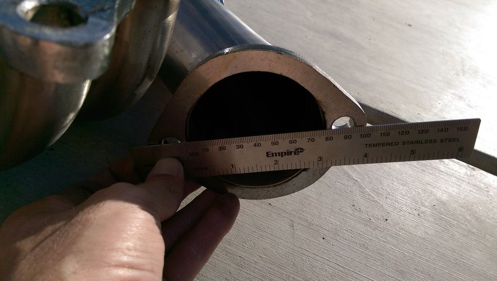

Here are pictures, even came with a secondary O2 spacer. Crap it says they are to big let me fix that. Also I can't find my calipers so I used a straight edge sorry.

Alright there are some pictures I will try to install them tonight but I still have to take the stock ones off after getting the trans in.

Is it just the picture, or is the flange surface as rough as it looks here??

Correct me if I'm wrong, but there looks like there's already corrosion on the part and the welds are not complete on the primary/flange interface. Why waste your money?

It's a sticky residue on all the flanges that's all.
I to was worried about heat but I have a good amount of header wrap so I'm going to use that.
I think there are some smaller things they could have made cleaner in the flanges but other than that they look fine to me compared to the other brands I have had in my possession. (Agency Power, OFH, Borla)

This. Doesn't look bad considering price. It is shitty they copied but the product looks pretty decent.
