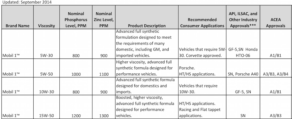

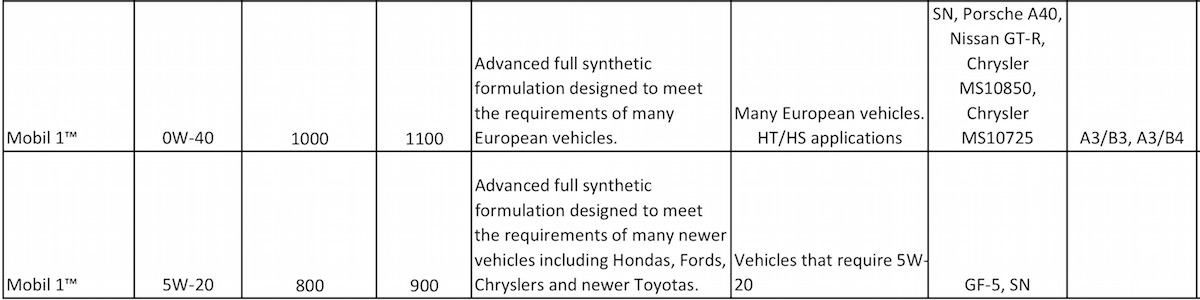

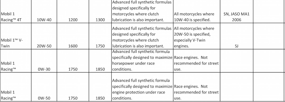

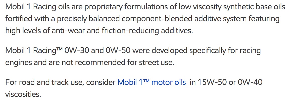

Not bad, I have mixed some 5w-30 with the 0w-40 before. Mobil 1 (on their website) has an official post in their FAQ section using those two as a comparison saying it is safe to mix. Personally, I like the higher zinc in the 0w-40. The 15w-50 also offers the higher zinc as well. It just easier to get these oils at walmart and auto stores vs other oils that may need to be special ordered.
Shot some pictures off of Mobil 1's website on the oils for you guys. Furthermore, the link attached is a current rebate offer Mobil 1 is doing until 31-MAY-2015 on getting $15 off 5qts and 1 oil filter. It's a great deal
