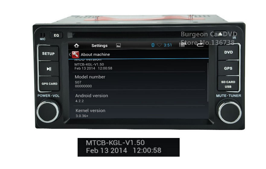

Is this in the same family of units as hui-fei, klyde, joyous, etc?
In About, do you see an MCU version like in this image?
I'm curious about that too, if it's in the same family they are charging a lot more for basically the same thing. At least on eBay

No, it is different device, different firmware compared to hui-fei. It has advantage of quad-core processor. However, it cannot be rooted (at least at the moment) which might be a downside for some advanced users.

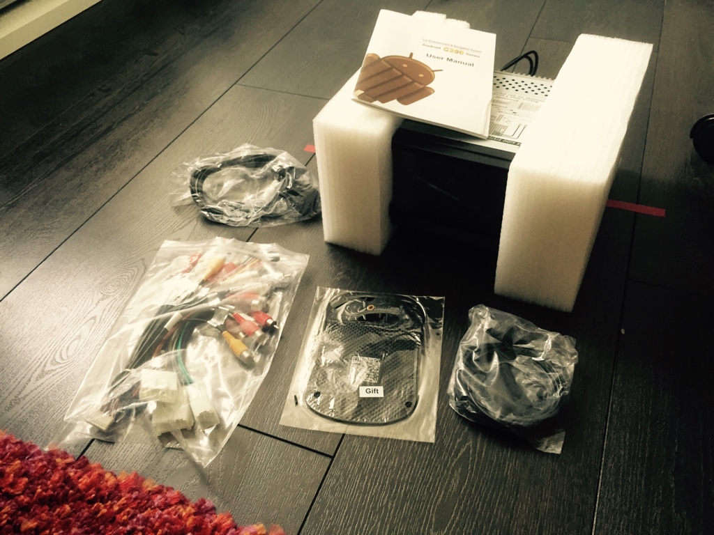

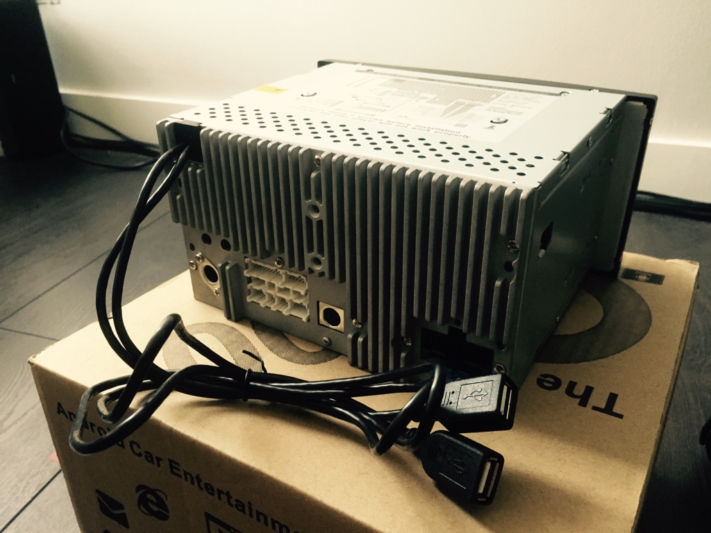

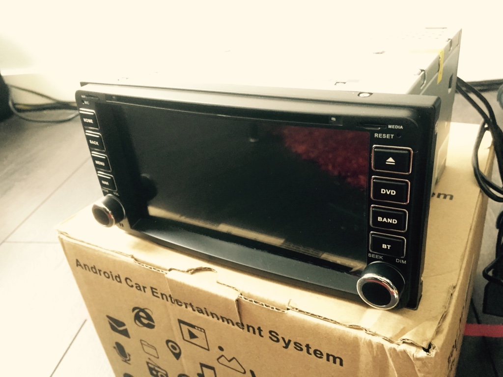

I ordered the unit from the Ownice store on eBay, overall it was a pleasant experience, any question I had they answered quickly. Also making sure that they had the Canadian maps for the GPS. The HU came double boxed which was pretty nice and a really funny thank you note.Name:  ImageUploadedByTapatalk1436417788.905407.jpg

Just finished the installation, it was probably one of the easiest I have ever done in a car. Make sure to connect the 'amp' wire from the HU to the 'brown' wire from the factory to turn on the power for the front door speakers.
The HU like the main poster said sits a bit recessed and deep. Might not bother some. I didn't feel like dremelling or drilling so I added some washers behind the HU bracket to push the HU forward. Not as flush but good enough for me.
The washers were aprox 2.5 mm thick
